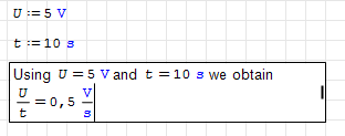

BTW, there is a workaround for storage as is: the line operator. It is meant as a block operator for multi-line sequences of statements in programming and in single line definitions it looks just ugly.
Yet, still I have no idea as how to actually access or display the stored value.

For now the best you can do is displaying the values in a common text region along with the formula and the result. That might be as good as substitution display for reviewers. It gives you full control over the display of the substitution values (dec prec and units) and of the result, separately.
