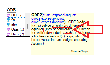

Why is saying that its not a proper differential equation?

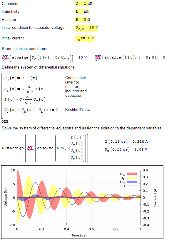

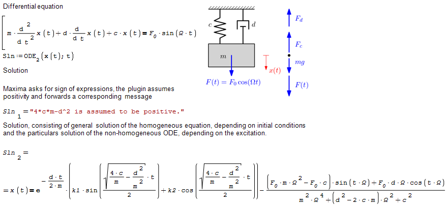

#6 Posted: 10/8/2024 3:11:16 PM
1,361 likes in 2,275 posts.
And there are also some approach using maxima engine/command?
Sure. Here is one using Maxima's desolve function and one using ODE.2 (without solving for the integration constants)
RLC.sm (23.17 KiB) downloaded 1673 time(s).
Feder-Masse.sm (23.13 KiB) downloaded 1686 time(s).

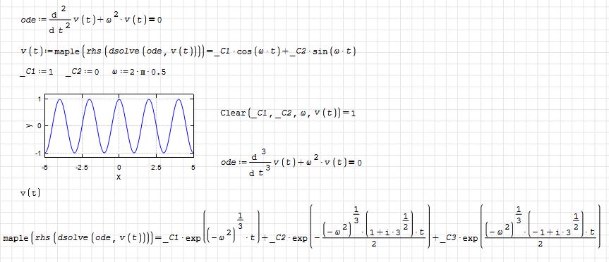

Martin, do you have an example for a third order differential equation on how to solve it? because ode2 is limited to second order differentia eq as far as I understood. And my previous question was on how to sollve a differential eq of order > 2 (3, 4, etc)?
#8 Posted: 10/9/2024 6:47:10 PM
Here I cirumvent the limitations of the translation using multiple intervals of integration. Example from the interactive handbook.
Worksheet36.sm (40.73 KiB) downloaded 2380 time(s).
