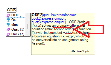

Why is saying that its not a proper differential equation?
#2 Опубликовано: 07.10.2024 17:20:54
StvMath
StvMath
44 сообщений из 76 понравились и 1 не понравились пользователям.

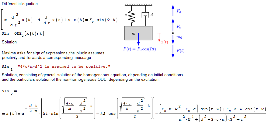

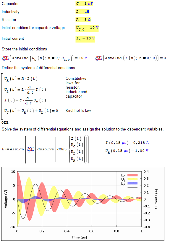

#6 Опубликовано: 08.10.2024 15:11:16
And there are also some approach using maxima engine/command?
Sure. Here is one using Maxima's desolve function and one using ODE.2 (without solving for the integration constants)
RLC.sm (23,17 КиБ) скачан 1673 раз(а).
Feder-Masse.sm (23,13 КиБ) скачан 1686 раз(а).

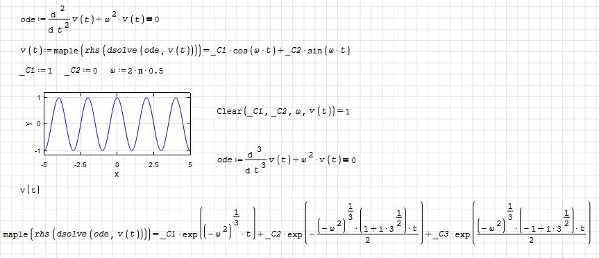

Martin, do you have an example for a third order differential equation on how to solve it? because ode2 is limited to second order differentia eq as far as I understood. And my previous question was on how to sollve a differential eq of order > 2 (3, 4, etc)?
#8 Опубликовано: 09.10.2024 18:47:10
Here I cirumvent the limitations of the translation using multiple intervals of integration. Example from the interactive handbook.
Worksheet36.sm (40,73 КиБ) скачан 2380 раз(а).
