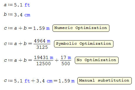

The only current way to make it work is to manually write the formula with the values and units in it, but this totally defeats the point of having a powerful program like SMath!

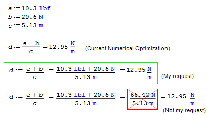

I can do manual calcs on paper without any programs...
All that is needed is for the display of the initial substitution, with the user defined units, before the final result is shown.
We don't need the formula evaluated with the user defined units, we only need the substitution displayed in the format of the expressed formula, that's it!
Like this:
It's totally fine if the default result is in default units, the user can manually define other units as needed.

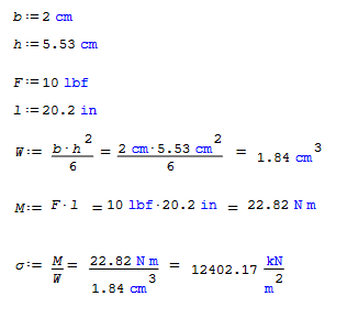

Oh, now I understand the misunderstanding. With intermediate result I mean the handling of cascades of equations. E.g. you might want to compute stress by
W = b*h^2/6 being the section modulus, M=F*l being the bending moment.
You can put all this into a single equation or display M and W separately.
If you then write sigma=M/W and ask for display with substitutions, then we both want the same: display the value as it was formatted in earlier displays (as in your example with g.e, where you just set the favourite units.)
Still I think that it would be clean to separate storage (definition) and display (evaluation) options. But that is just for easier explanation/teaching.

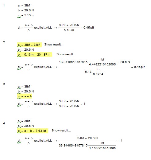

Here is what I propose: allow a user to apply 「evaluation」 to a variable, so that a:=b+c can be written as a:=(b=12mm)+c where b is defined as 12mm before this equation, the result is just shown inline. Just like any other evaluation, units can be modified inline: a:=(b=12mm▮)+c --> a:=(b=0.47in)+c; the inline 'display result' of variable b would also grant the user to declare symbolic/numeric/none as optimization, as well as decimal points/fraction/rounding conditions currently enjoyed by an equation.
One way to think about it is that a mathregion can be nested within a mathregion:
If such an implementation can be pulled off, this nesting effect can be applied 「n」 levels deep. I think such an operation would require the variable being displayed to be contained within parentheses; if a new operator/grouping is required to make this happen, curly brackets { } could be used to contain/display/interact with such a feature (those keypresses seem to be empty, and the difference between { and ( is slight, but noticeable)
Exactly, now we are on the same page. I also agree that we need to separate the definition and display of substitutions, as you have called it. I think the storage definition is going to be much harder than just the display.
Here is a visual of your example:

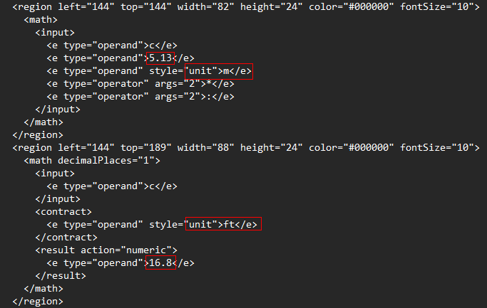

As for the display for the variables, you can see it right in the html code. Both the user defined units, and the number of decimal places are there.
Remember, we are talking only about the display of the variables substituted into the defined equation exactly as they are displayed before the equation. In the background, the evaluation is still numeric as before.

You can assign whatever units you want to each calculation individually. Default units are just for calculations in the background. You can even change in which units the result is displayed.
As I showed before, both the decimal places and the units that are displayed are part of the html code. So these "definitions" as we might call them, should be able to be recalled as such, and substituted and displayed in the format of the equation they are placed into.
Again folks, what I am proposing, is simply a display of what is already displayed. Everyone keeps thinking within the bounds of how SMath currently works.

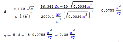

Here is an example of a nonsense equation that is a bit more complex in its formatting.
As you can see, c has only 1 decimal place, while a and b have 3. The default decimal place setting is 2.
So when the calculation of d is performed, the result is shown with only 2 decimal places, because of the default setting. I can change that if I want.
The variables are displayed in the format of the equation exactly as they are previously displayed.
Lets say that I decide to show the result of d with 4 decimal places instead of 2, and then I use it in a new equation, d will be shown with 4 as it is shown just before the equation.

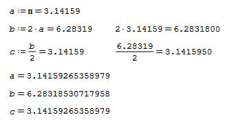

Isn't this no different than how things are now? If you define a variable out to 15 decimal places, the calculations will carry that precision through. If you define it only to 4 decimal places, then 4 is all you can get. In the end you can chose to display values differently than how SMath is using them in the calculations. Even when you get a result from an equation. That result has a level of precision that is determined by the level of precision of the variables/numbers used in the equation. You can still chose to display 2 or whatever decimals you can.
In this example, pi is defined out to 15 decimal places, I am choosing to display only 5 decimal places, but the calculation is being done with the full 15. On the side is the direct substitution calculation with the numbers as displayed. As you can see, it produces different results.
Now in this example, I have defined pi only to 4 decimal places. With trailing zeros on, you can see that the calculation is limited by the 4 decimal places I have defined.
When we mix "accuracy" we see that we get a total combined level of precision. 6+4=10.
So I'm not sure it would be any different for what I'm asking for. The calculation would still be done as before, just like any other numerically optimized calculation. Even the final result would be the same as before. You would chose how to display it, but the calculations are being done to full possible precision.
I have no idea how this would be done if you want to show step by step simplifications of equations (which is not what I'm looking for). That seems like a much bigger/harder problem to solve.
