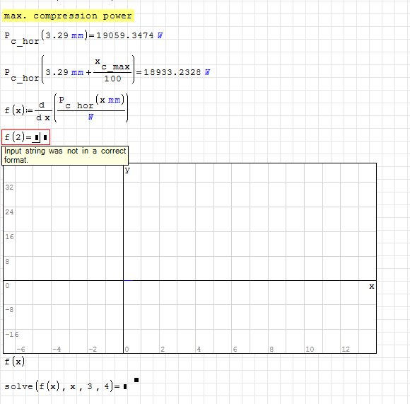

I am currently struggling with a basic function extreme problem
NOK.sm (15 KiB) downloaded 1268 time(s).
OK.sm (60.92 KiB) downloaded 1216 time(s).
edit by mod: names of attachments are swapped, as mentioned below
In the first screenshot, the function derivative definition results in a warning message: "input string was not in a correct format"

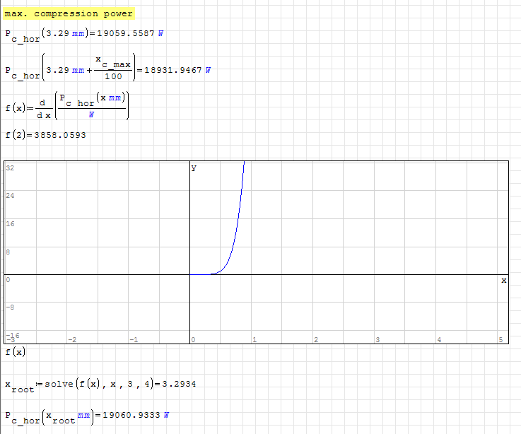

In the last screenshot, I removed all parameters values that aren't related to the given formulas (not visible in the screenshot), and I get the right solution?! However, I don't see the root visually in the accompanying graph?
I thought it had something to do with the reservation of parameter "x", but this doesn't seem to be the case...
Thanks in advance for any feedback!

What I meant was that the derivative graph doesn't cross the X-axis at x=3.29, this is where the original function P_c_hor(x) reaches it's maximum.
This is odd, since the root function indicates correctly a root at x=3.29 in the file NOK.sm (I switched the names the smath files, my mistake... ).
So my question remains: why does the solve function doesn't work in both attached files?
