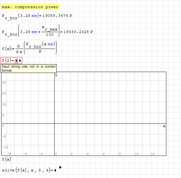

Dear all,
I am currently struggling with a basic function extreme problem
NOK.sm (15 КиБ) скачан 1268 раз(а).
OK.sm (60,92 КиБ) скачан 1216 раз(а).
edit by mod: names of attachments are swapped, as mentioned below
In the first screenshot, the function derivative definition results in a warning message: "input string was not in a correct format"

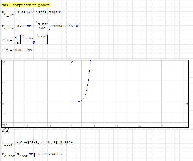

In the last screenshot, I removed all parameters values that aren't related to the given formulas (not visible in the screenshot), and I get the right solution?! However, I don't see the root visually in the accompanying graph?
I thought it had something to do with the reservation of parameter "x", but this doesn't seem to be the case...

What I meant was that the derivative graph doesn't cross the X-axis at x=3.29, this is where the original function P_c_hor(x) reaches it's maximum.
This is odd, since the root function indicates correctly a root at x=3.29 in the file NOK.sm (I switched the names the smath files, my mistake... ).
So my question remains: why does the solve function doesn't work in both attached files?

I made a revised version of my original document today, based on your remarks. Luckily, I managed to keep the units "on board": by doing so the document is more readable for my colleagues.
Every value is correctly evaluated now: yes!
Thank you for the hint about the infinitesimal derivative, let's hope that SMath's next version will have a flawless standard derivative function, since the actual one doesn't seem to work...

I run the latest beta (build 6437), and f(2) on the last page of "ok.sm" doesn't result in an answer (the standard smath derivative function doesn't work)? I run Windows 7 Pro.
"nok.sm" does work, the reason for this is unclear because exactly the same formulas are used, however the graph doesn't show the correct shape of the derivative function.
It would be very strange if your configuration would be errorless?
There has to be a program mistake somewhere?
