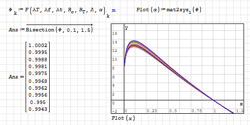

I am trying to find the k values of alpha that are roots of the system of k transcendental equations. I don't understand the required syntax.

Hi Reg. You can try this.
LITTLE BOY LAMBDA AND ALPHA.sm (93.57 KiB) downloaded 1670 time(s).

Thanks. I will give that a try. I found a couple of typos in my definition of the elements of F. But, I will fix that and try your method.
I got a little further using the solve function; however, I am having trouble getting it to plot.
LITTLE BOY LAMBDA AND ALPHA.sm (63.61 KiB) downloaded 1630 time(s).
