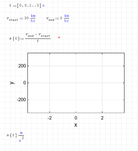

Hi All,
Could you direct me how to plot the function for some range?
plot in range.sm (5.55 KiB) downloaded 1242 time(s).

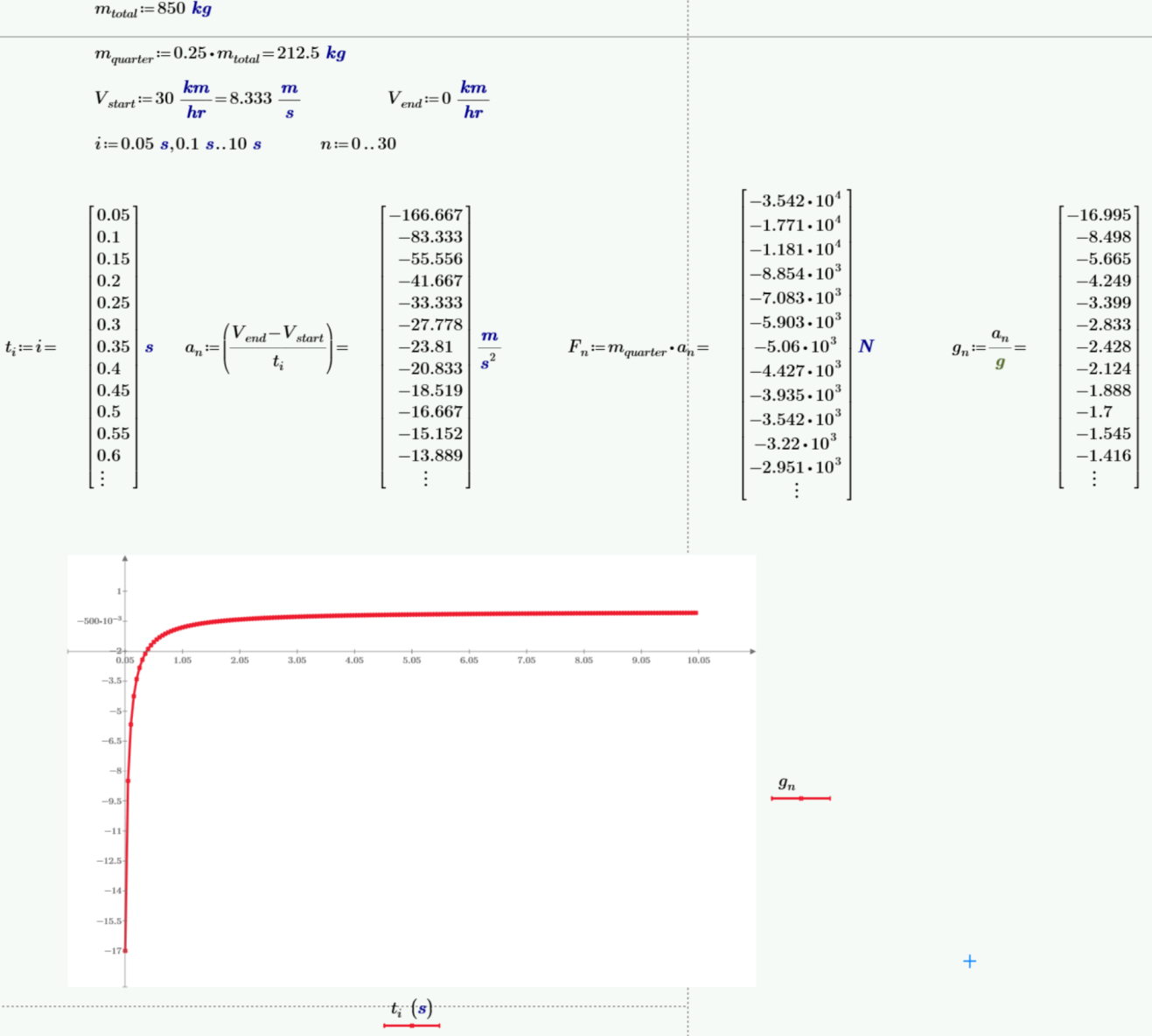

It looks like that both solution are not what I want to get - especially the first one...
Is there any possibility simply to plot the chart where on Y-axis I simply put the a(t) and on x-axis time??? Because this what you proposed it looks tricky and there is necessity to control units. Therefore it is not intuitive ( at least for me ;P )
Please check the photo below made by ptc mathcad. This what I want to do, is to write the same as the function and plot it using the SMath.
Mateusz
Mateusz

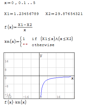

WrotePlease check the photo below made by ptc mathcad. This what I want to do, is to write the same as the function and plot it using the SMath.
If that plot is what you need, here is your answer.

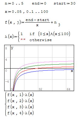

With function, dots for values and new axes grid {0.05, -2}.
plotting_range.sm (10.98 KiB) downloaded 1196 time(s).

Hi Ber7,
This the acceleration during the breaking from 30km/h to zero in linear movement. Therefore in fact there is a(t)= v(t)/t. So: a_i= v_i / t_i and this is function where t is in some range, and i is the iterative change of time ie. the position of specific time. This what you wrote, is not the function of acceleration versus time.
Mateusz

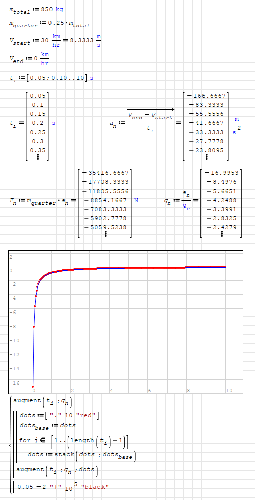

Differently convenient plot ...
plotting_range [1].sm (11.48 KiB) downloaded 1041 time(s).
