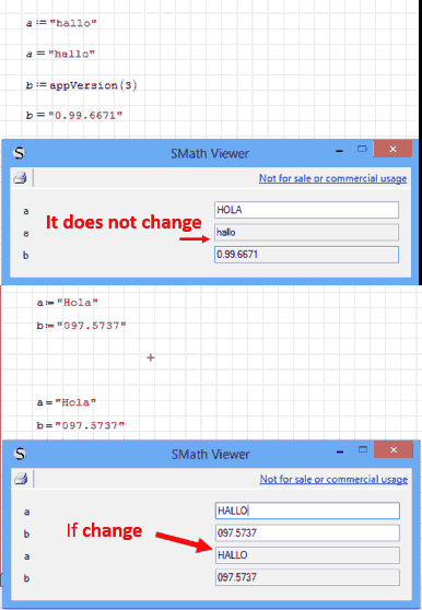

I have a question if it's possible to display the string part of a matrix in *.exe file created from a Smath file?
Screenshot of issue
Tried the var2string function, but after changing the string value via exe file, it reads function argument name (a) instead of it's value.
Is there some kind of workaround for this issue?
Screenshot of issue

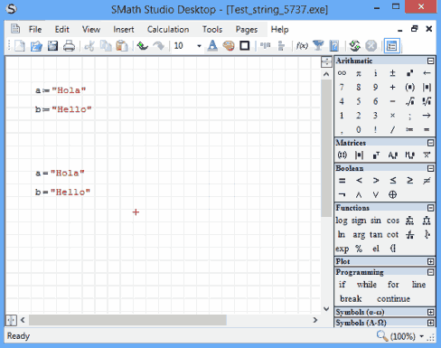

Hello Barmin
The function you are looking for was previously available in previous versions of smath, such as version 5737.
I do not know why they disabled it. Here I put an example in that version.
Test_string_5737.zip (359.64 KiB) downloaded 416 time(s).

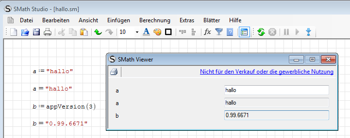

#7 Posted: 7/2/2018 11:07:17 AM
1,359 likes in 2,273 posts.
Can't reproduce
hallo.sm (2.75 KiB) downloaded 1149 time(s).
hallo.zip (482.23 KiB) downloaded 399 time(s).

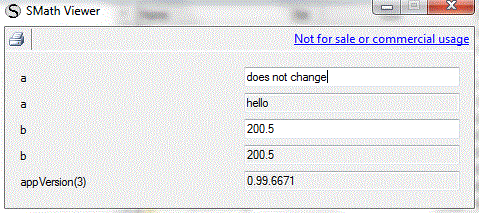

#8 Posted: 7/2/2018 11:11:51 AM
Arie
Arie
94 likes in 285 posts.
Martin,
Once the Viewer is running try to change the value of Hallo and notice if it doesn't update in the second box.

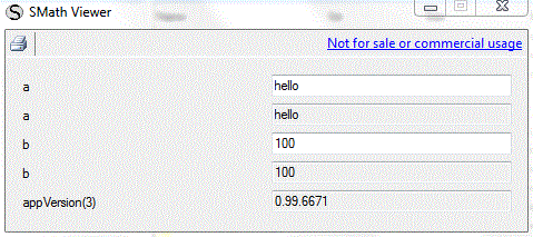

#11 Posted: 7/3/2018 6:14:27 AM
For me it will change the numerical variable but not the string one (with return pressing, of course).
before
after

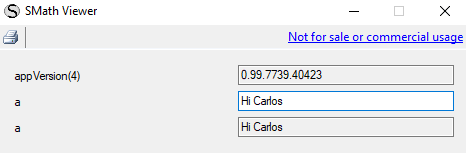

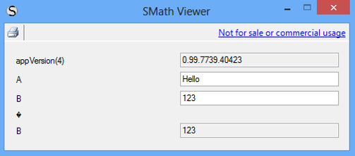

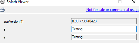

#18 Posted: 3/12/2021 10:08:51 PM
26 likes in 155 posts.
Seems to be working just fine for me.
99.7739.40423_Test_exe.zip (571.28 KiB) downloaded 375 time(s).
Good Luck!

#20 Posted: 3/12/2021 11:29:48 PM
1,138 likes in 1,805 posts.
I'm using 64bit Win10 Enterprise by the way. Maybe it matters?
Me too, but 32 bits. I'm reinstall SMath and now works fine.
