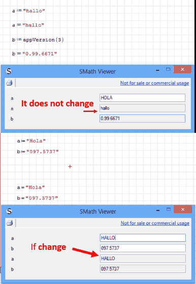

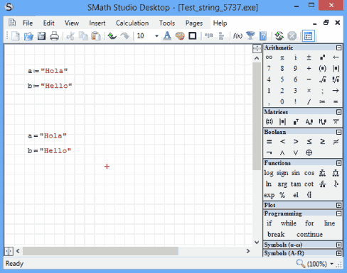

Hello Barmin
The function you are looking for was previously available in previous versions of smath, such as version 5737.
I do not know why they disabled it. Here I put an example in that version.
Test_string_5737.zip (359,64 КиБ) скачан 442 раз(а).

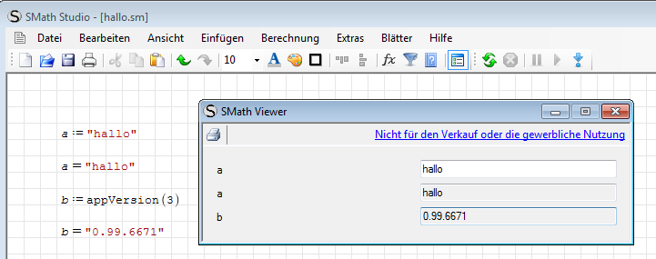

#7 Опубликовано: 02.07.2018 11:07:17
Can't reproduce
hallo.sm (2,75 КиБ) скачан 1190 раз(а).
hallo.zip (482,23 КиБ) скачан 424 раз(а).
#8 Опубликовано: 02.07.2018 11:11:51
Arie
Arie
Martin,
Once the Viewer is running try to change the value of Hallo and notice if it doesn't update in the second box.

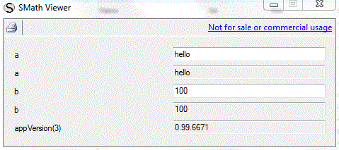

#10 Опубликовано: 03.07.2018 04:58:49
For me it works. Yet I have to press enter to forward the changes in the input box.

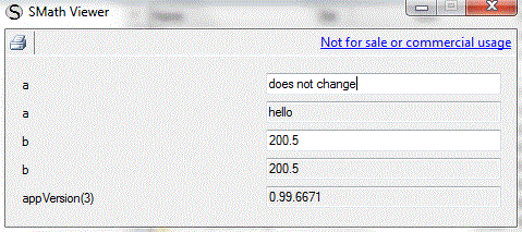

#11 Опубликовано: 03.07.2018 06:14:27
For me it will change the numerical variable but not the string one (with return pressing, of course).
before
after

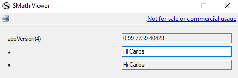

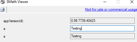

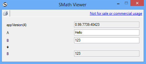

I did a test with the latest version of Smath Studio and the Viewer and it does not work
#17 Опубликовано: 12.03.2021 15:03:32
Hi. Carlos it's right. I guess that there are an issue with the automatic update within the nightly build which seems to be now appVersion(4)="0.99.7739.40423"@# but previously I have appVersion(4)="0.99.7739.41xxx "@# or something like that.
#18 Опубликовано: 12.03.2021 22:08:51
26 сообщений из 155 понравились пользователям.
Seems to be working just fine for me.
99.7739.40423_Test_exe.zip (571,28 КиБ) скачан 395 раз(а).
Good Luck!
#19 Опубликовано: 12.03.2021 22:12:22
I'm using 64bit Win10 Enterprise by the way. Maybe it matters?
Alvaro 12.03.2021 23:30:00
#20 Опубликовано: 12.03.2021 23:29:48
Me too, but 32 bits. I'm reinstall SMath and now works fine.
Thanks.
