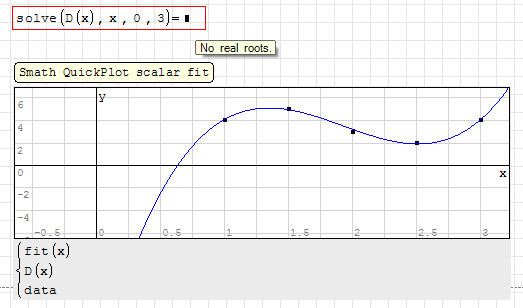

#3 Posted: 3/12/2016 10:52:53 AM
Non linear solver of some kind, poorly documented.
The Mathcad Given/Find would solve with an objective
function [my newbie interpretation]. The "M"
in the attached would solve "Pseudoinverse", posted
few weeks ago in the forum.
Polynomial fit_D[x].sm (18.53 KiB) downloaded 1052 time(s).
Alexander O. Melnik 3/12/2016 12:47:00 PM, frapuano 3/12/2016 12:55:00 PM

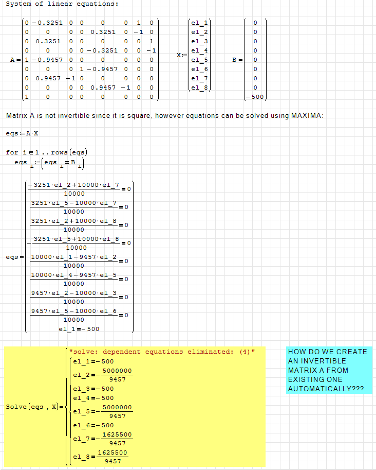

Anyway, from educations perspective, is the a way to solve the following without using Maxima:
solveMaxima.sm (16.48 KiB) downloaded 1221 time(s).

Alex,
As now things get more sense. Always an example or a sketch tell more than a long speech
Not importing on your mathematics tool you are in front of a mechanism case (physically speaking) that means that you have 3 equations and 4 unknowns.
Such a system has a simply infinity of solutions.
As I already said, you need a complementary condition to determinate the system from mathematical viewpoint.
One solution is to take one of unknowns as parameter and to determine it with an optimization technique, for instance in respect with the energy.
Three things here:
- Would you happen to know the answer from my previous post? I would prefer not to use Maxima unless I have to...
- A fake mechanism is quite typical in strut and tie, many of the typical solution-by-matrix will not work. Try to solve this (pin supports at each end of member) in any analysis software:
The mechanism is implied, but non existent in reality (we are looking at a chunk of concrete). Solution is generated by satisfying equilibrium at nodes.
- Im likely to revise my approach and define all conditions prior to, rather than after the solution - i appreciate your constructive criticism.

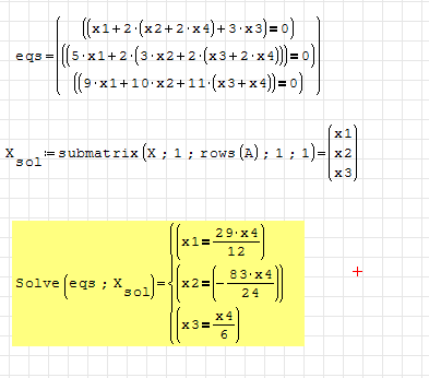

Ioan, one of the reasons why I am not going the FEA way for this task, is because in my design office there is a strong opinion against it (not the best tool for the task? influence of late James MacGregor? - I do not know) Those zero force members almost always end up carrying some load.. Anyway - I must do it the sum(F.x) = 0 & sum (F.y) = 0 way.
So if you, or anyone else know how to solve equations from post 11 the SMath way (3 equations, 4 unknowns, symbolic solution of 3 unknowns in terms of the 4th unknown) I would much appreciate it. So far I tried roots() and maxima's Solve(). Solve() works.

Jean, would you happen to know how to find and remove reduntant rows from a coefficient matrix A, that happens to have more rows than columns:
A x X = B
X = A^-1 x B
SolveEquationMaxima.sm (14.67 KiB) downloaded 1190 time(s).
A x X = B
X = A^-1 x B
This is solved using DotNumerics plugin.
Thanks, Uni!
SolveEquationDotNumerics.sm (9.73 KiB) downloaded 1210 time(s).

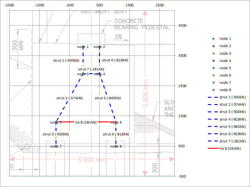

And a little teaser of what I am working on... Everything you see was created by an EXCEL macro (from graphical representation perspective), solved in SMath and presented in EXCEL.
Process of model creation / presentation / solution is fully automated.
By the way, Ioan, SMath solution of this strut & tie worked from the very first attempt - felt like a miracle

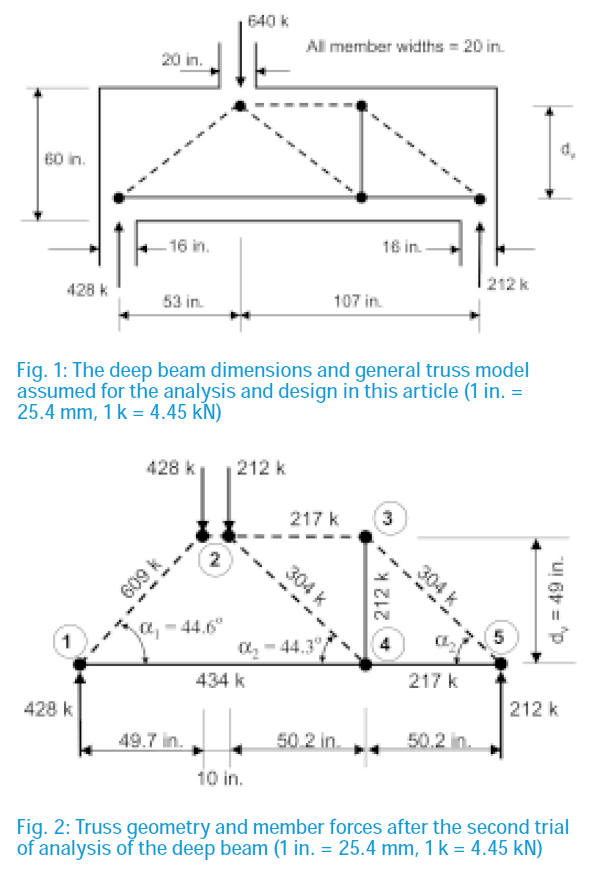

For instance in the appended document ci2505wight.pdf (155.21 KiB) downloaded 11611 time(s).they go to modify the physical height of the beam in order to satisfy the model, what's not usual in engineering.
However, the subject is for specialists and therefor, I decline my intrusions; I'm a specialist but not in this item.
It's strange for me to understand how they obtained that the reaction on the left support is 428k while a simple calculation gives 640*107/(107+53)= 361k and the beam is nothing that a simply supported beam. Does the beam know this forcing "joke" ?
As I know the apparently forum composition, it is not here the right place to "negotiate" such a fine item

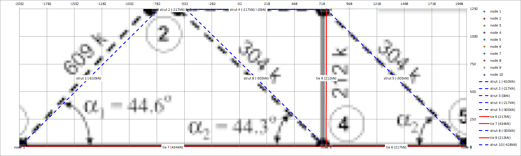

And this little guy took me about 20 minutes to setup.. Mostly defining coordinates and stuff. If the drawing was to scale I could have just located the nodes of my strut & tie graphically.
Small typo:
640*107/(107+53)= 428

Very impressive and clean truss model, Ioan, looks great.
Side thought - I am not really going "outside from the road" with my solution... simple force equilibrium at nodes. We can chat more.
