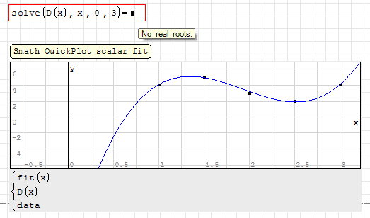

Non linear solver of some kind, poorly documented.
The Mathcad Given/Find would solve with an objective
function [my newbie interpretation]. The "M"
in the attached would solve "Pseudoinverse", posted
few weeks ago in the forum.
Polynomial fit_D[x].sm (18,53 КиБ) скачан 1052 раз(а).

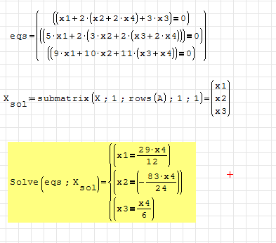

Anyway, from educations perspective, is the a way to solve the following without using Maxima:
solveMaxima.sm (16,48 КиБ) скачан 1221 раз(а).

So if you, or anyone else know how to solve equations from post 11 the SMath way (3 equations, 4 unknowns, symbolic solution of 3 unknowns in terms of the 4th unknown) I would much appreciate it. So far I tried roots() and maxima's Solve(). Solve() works.

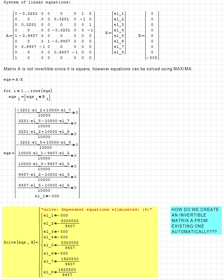

Jean, would you happen to know how to find and remove reduntant rows from a coefficient matrix A, that happens to have more rows than columns:
A x X = B
X = A^-1 x B
SolveEquationMaxima.sm (14,67 КиБ) скачан 1190 раз(а).
A x X = B
X = A^-1 x B
This is solved using DotNumerics plugin.
Thanks, Uni!
SolveEquationDotNumerics.sm (9,73 КиБ) скачан 1210 раз(а).

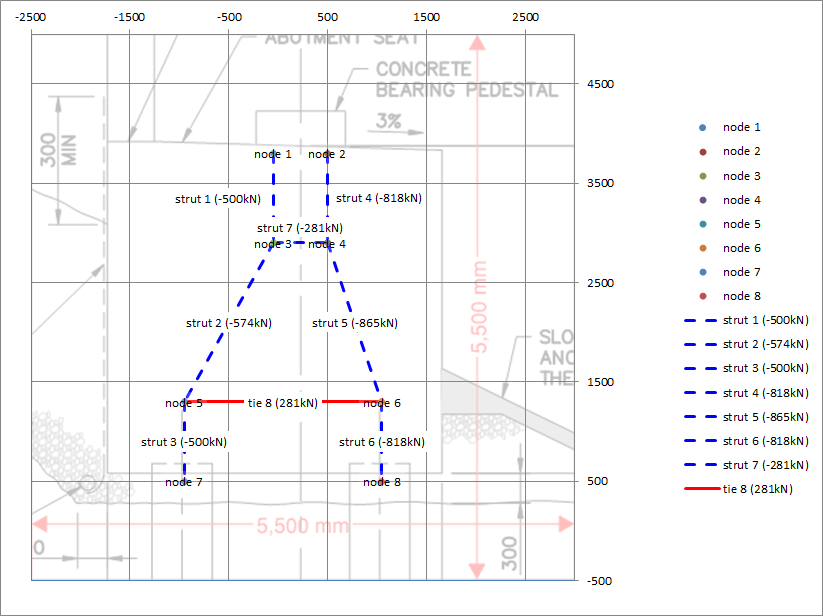

And a little teaser of what I am working on... Everything you see was created by an EXCEL macro (from graphical representation perspective), solved in SMath and presented in EXCEL.
Process of model creation / presentation / solution is fully automated.

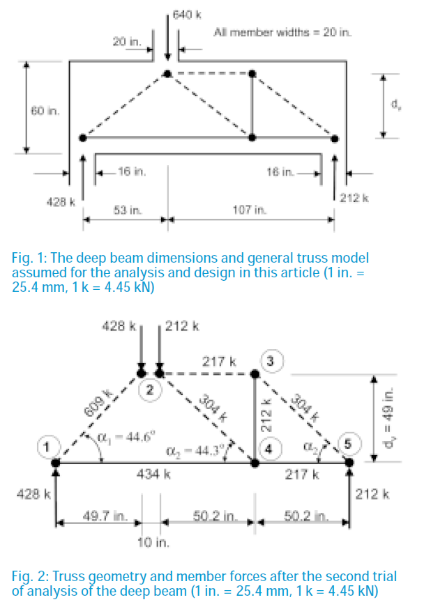

I googled around the subject and I noticed an enormous quantity of documents, many dedicated to the experimental side.
It seems that the treatment is often very specific to any concrete problem.
For instance in the appended document ci2505wight.pdf (155,21 КиБ) скачан 11611 раз(а).they go to modify the physical height of the beam in order to satisfy the model, what's not usual in engineering.
However, the subject is for specialists and therefor, I decline my intrusions; I'm a specialist but not in this item.
It's strange for me to understand how they obtained that the reaction on the left support is 428k while a simple calculation gives 640*107/(107+53)= 361k and the beam is nothing that a simply supported beam. Does the beam know this forcing "joke" ?

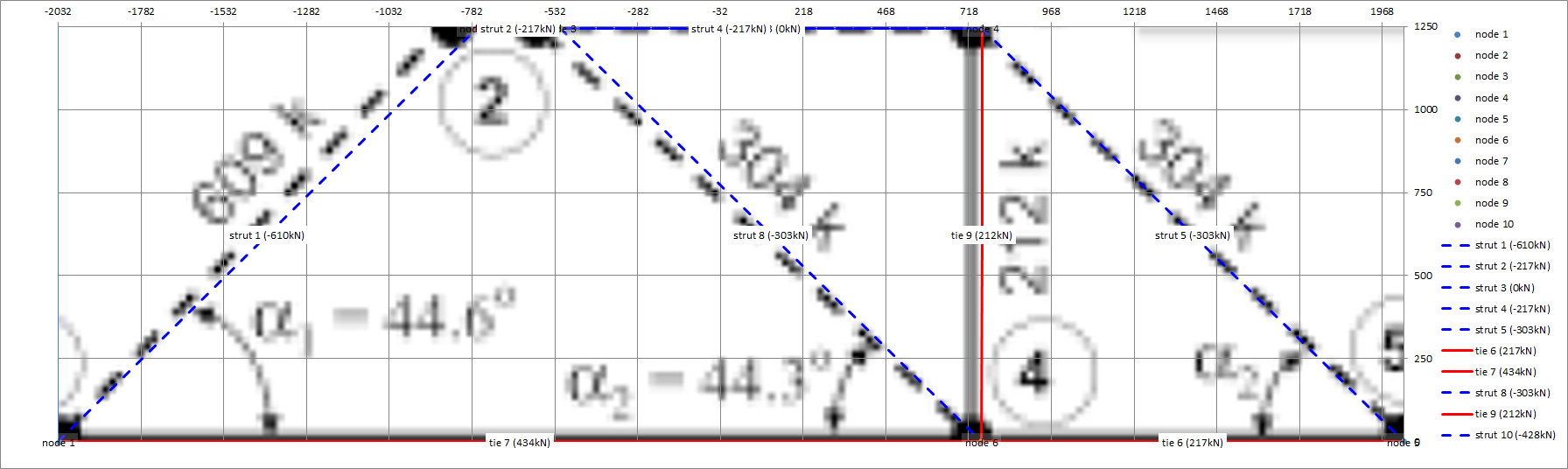

And this little guy took me about 20 minutes to setup.. Mostly defining coordinates and stuff. If the drawing was to scale I could have just located the nodes of my strut & tie graphically.
Small typo:
640*107/(107+53)= 428

Did not expect this topic to spur such a conversation but hey, the more opinions the merrier!
Very impressive and clean truss model, Ioan, looks great.
Side thought - I am not really going "outside from the road" with my solution... simple force equilibrium at nodes. We can chat more.
Alex
