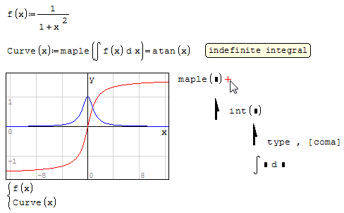

Generally, like this.

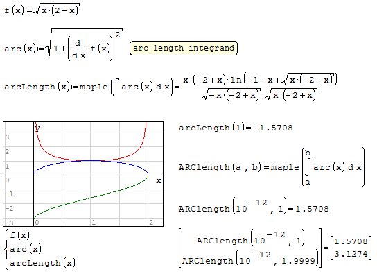

Integrate_000000 [ Source Code Maple].sm (9.66 KiB) downloaded 1379 time(s).

For reference, I just installed SMath. I installed maple. Where is the integrate sign located in the program?

Welcome to the forums. Jean's first post outlined a how to create the indefinite integral, although it might not have been clear.
For example, to create the integral for x^2, you can type "int(x^2,x)" without quotes.
I do not believe there is a toolbar button for the indefinite integral.

Thankyou. int( x^2,x) was what I was looking for (and I see now what that first picture was suppose to be /headdesk). I tried the example mentioned above with maple installed but I don't see the answer like I saw above. I see this instead.

Try right click and change optimization to symbolic.
Also you can use symbolic evaluation by hitting Ctrl + . (That is Ctrl and period) instead of =

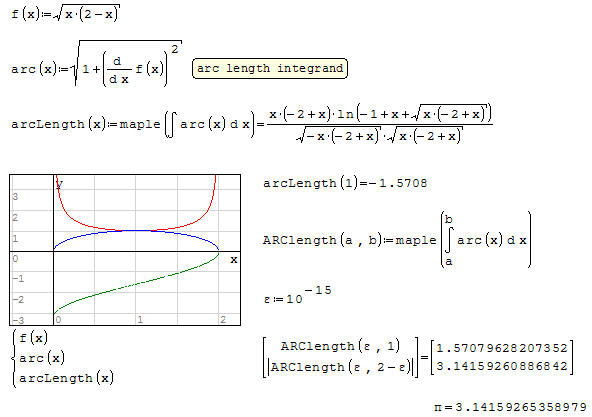

Integrate Wisely [Arc Maple].sm (8.54 KiB) downloaded 1095 time(s).

... this attached example is of prime importance.
It shows by how much the Simpson integrator can be OFF track !
Not even the first decimal is true !
Integrate Wisely [Arc Lagrange].sm (44.76 KiB) downloaded 1097 time(s).
