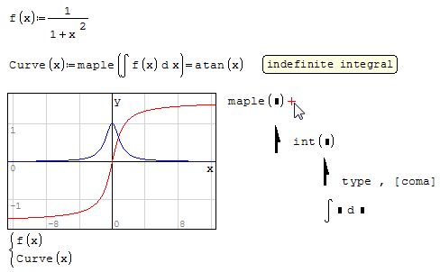

How do I integrate symbolically?
#2 Опубликовано: 10.05.2018 21:54:23
How do I integrate symbolically ?
Generally, like this.

For reference, I just installed SMath. I installed maple. Where is the integrate sign located in the program?
Hi Ryu
Welcome to the forums. Jean's first post outlined a how to create the indefinite integral, although it might not have been clear.
For example, to create the integral for x^2, you can type "int(x^2,x)" without quotes.
I do not believe there is a toolbar button for the indefinite integral.
-alyles

Thankyou. int( x^2,x) was what I was looking for (and I see now what that first picture was suppose to be /headdesk). I tried the example mentioned above with maple installed but I don't see the answer like I saw above. I see this instead.
#14 Опубликовано: 11.05.2018 11:49:59
Arie
Arie
Try right click and change optimization to symbolic.
Also you can use symbolic evaluation by hitting Ctrl + . (That is Ctrl and period) instead of =

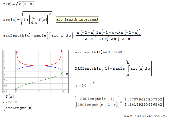

Copy the image, paste in blank work sheet ... try to do it yourself.
Try hard !!! rescue yourself by downloading the work sheet.
It should work in your latest Smath version.
Integrate Wisely [Arc Maple].sm (8,54 КиБ) скачан 1095 раз(а).

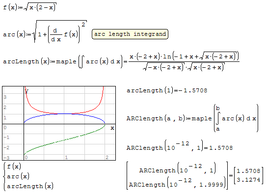

... be productive to integrate, try it.
#17 Опубликовано: 11.05.2018 13:44:31
... this attached example is of prime importance.
It shows by how much the Simpson integrator can be OFF track !
Not even the first decimal is true !
Integrate Wisely [Arc Lagrange].sm (44,76 КиБ) скачан 1097 раз(а).
