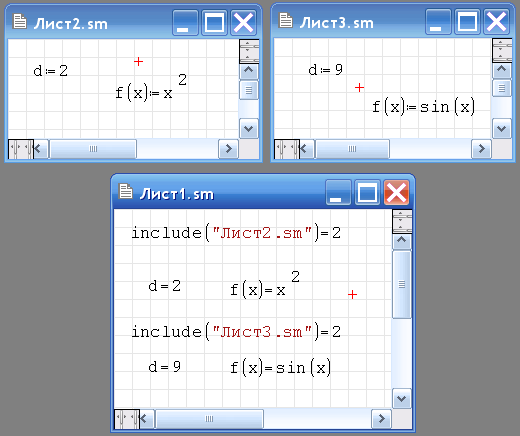

#11 Posted: 3/2/2016 3:53:19 PM
1,558 likes in 1,868 posts.
For me it's enough interesting if we can include already build functions form various individual files, for avoiding copy/paste or snipets.
My simply question is if there are in such cases some invisible "collisions" risks, by the use of many "included" functions in a file.
It is necessary to avoid recursion. I still can't catch this type of error in all cases. The only thing to keep in mind - it is the replacement of definitions. But I think this is normal behavior. Or you can suggest the rules how to resolve such kind of collision.
ioan92 3/2/2016 3:54:00 PM, Davide Carpi 3/2/2016 7:53:00 PM
#12 Posted: 3/2/2016 3:59:02 PM
Davide -> I updated the plugins but I still seem to have the same issue. Should I be getting a different result?
Thanks
The error in the comboboxlist (or other controls plugins) shouldn't be triggered anymore.
include has a lot of potential, being able to run several worksheets at once from a single worksheet (as stated by you, a sort of improved snippet); the possible collisions (if you don't know the limits):
1) regions with an output to the canvas are not managed -> you may expect values are processed by the regions in the included worksheets, this doesn't happens;
2) there's not a check on the dependancies -> running the worksheets on another system you may miss the required plugins or (in the worst case) a different function with the same name of another (from another plugin not available in the source system) may be incidentally used with unpredictable results.
Вячеслав Мезенцев 3/2/2016 4:02:00 PM, ioan92 3/2/2016 4:17:00 PM

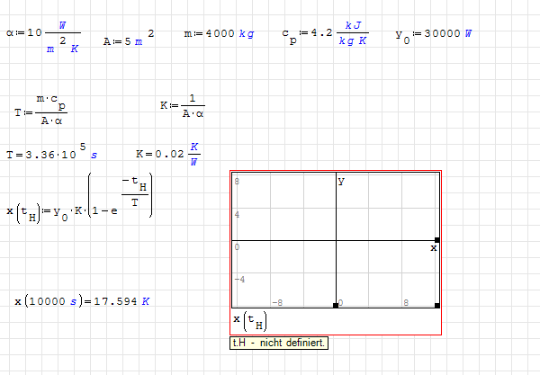

#16 Posted: 3/3/2016 10:24:10 AM
Lerch
Lerch
0 likes in 4 posts.
Hi all
2D Plot does not work with units
I tried to plot a function according the instruction of Sebastian Schluricke shown at www.youtube.com/watch?v=AtICkHXHFpk
His example I could easily do. But as soon if I go over to my calculations where I work with units I cannot plot them. I receive only the message variable not defined.
What is wrong here?
Kind regards
Gaselhul

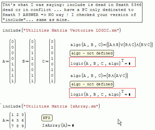

#17 Posted: 3/3/2016 1:02:21 PM
Salut Ioan,
I most appreciate your convincing demo.
Happy users if "include" 5346 works for you.
Dead for me, I don't care much.
Now: plugin & plugin ... as an individual user
fine as Smath a permanent "beta version". For
clients [remote clients] ... NO way to update
day by day as plugins arrive and often not
fully proven [not a critic].
Smath is like Mathcad was: you need a huge tool
box to fully exploit. Several hundred of tools.
At this point, a list of tools is needed and
must be updated ... something like Matlab
10 km long. Personal tools may be at risk !
My hart for Smath abounds for more essential
functionalities [clipboard ...] and more maths
[fft, integration, ... the list is long]
Most interesting is like this:
If Samth users find my Smath tool box profitable
to "include", it's possible to collect, will take
quite a while to group ~ 150 work sheets with minmum
application examples ... just going back to Smath
repository that was not so much welcomed.
Maybe Smath does not want to become a winner like
Mathcad 8 Pro. did.
Cheers to all, Jean
