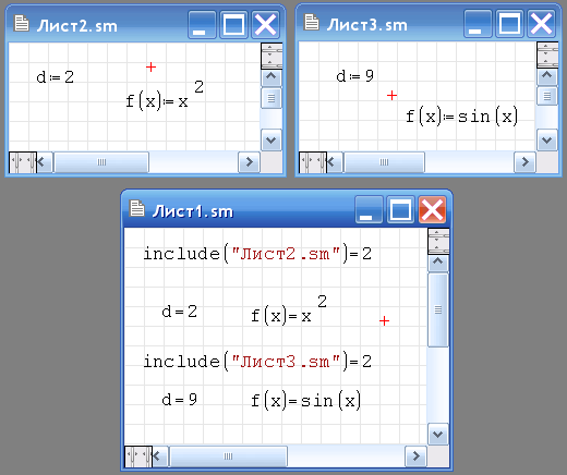

As explained by Viacheslav here include doesn't load the regions (any region), it loads only the xml code of the math regions. Hence, the ComboBoxList in "Loads - Gravity.sm" acts like it is disabled -> the output value K.LL is an unknown -> q.LLResult is not defined because not all the arguments are defined.
As stated before (I can't find the thread) probably it is possible to provide a fix working on both sides (include plugin and any region plugin that feed the canvas with values, adding a hook in the xml), however the behavior would be static (what is saved is what you have).

It is necessary to avoid recursion. I still can't catch this type of error in all cases. The only thing to keep in mind - it is the replacement of definitions. But I think this is normal behavior. Or you can suggest the rules how to resolve such kind of collision.

include has a lot of potential, being able to run several worksheets at once from a single worksheet (as stated by you, a sort of improved snippet); the possible collisions (if you don't know the limits):
1) regions with an output to the canvas are not managed -> you may expect values are processed by the regions in the included worksheets, this doesn't happens;
2) there's not a check on the dependancies -> running the worksheets on another system you may miss the required plugins or (in the worst case) a different function with the same name of another (from another plugin not available in the source system) may be incidentally used with unpredictable results.

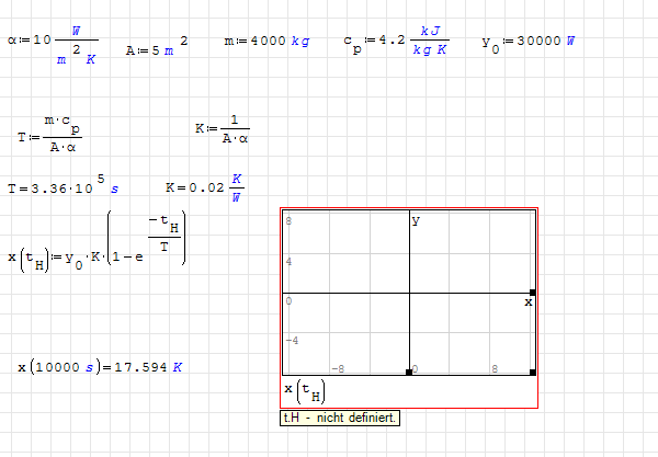

2D Plot does not work with units
I tried to plot a function according the instruction of Sebastian Schluricke shown at www.youtube.com/watch?v=AtICkHXHFpk
His example I could easily do. But as soon if I go over to my calculations where I work with units I cannot plot them. I receive only the message variable not defined.
What is wrong here?
Kind regards
Gaselhul
![2016-03-03 14_23_11-SMath Studio Desktop - [Aufheizkurve Bad.sm_].png](/ru-RU/files/Download/XhdELM/2016-03-03-14_23_11-SMath-Studio-Desktop---[Aufheizkurve-Bad.sm_].png)

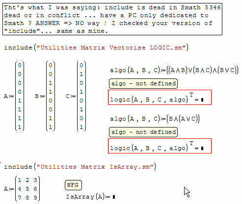

I most appreciate your convincing demo.
Happy users if "include" 5346 works for you.
Dead for me, I don't care much.
Now: plugin & plugin ... as an individual user
fine as Smath a permanent "beta version". For
clients [remote clients] ... NO way to update
day by day as plugins arrive and often not
fully proven [not a critic].
