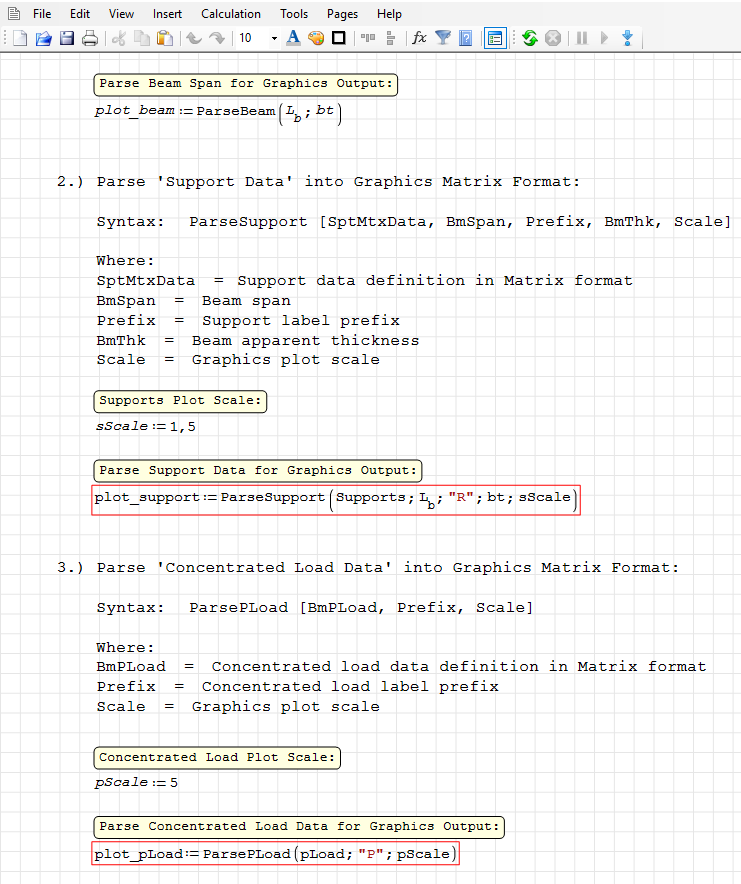

Hi everybody,
I'm trying to use the Structural Beam Analysis plugin, but I've got some problems.
When I open the “Beam Analysis” example I've got the next problem.
The error says "Indice fuera de los limites de la matriz" (Index outside matrix boundaries)
Could somebody help me with that?
Thanks in advance

I've got the problema with the example that's why I didn't send the file before.
You can find it attached.
Thanks

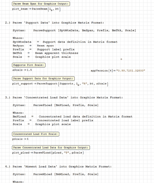

#9 Posted: 1/21/2020 8:12:13 AM
e.artola
e.artola
0 likes in 4 posts.
I continue with the same error.
Could somebody show me how to solve it please?
Thank you in advance
#10 Posted: 1/21/2020 11:48:48 AM
NDTM Amarasekera
NDTM Amarasekera
130 likes in 352 posts.
The original file showed Red while opening, but finally opened successfully in SS 7251.
Then saved as with a new name, which opens later without any such hassle.
The renamed file is attached, including the PDF. I did not do any changes.
Hope you will be able to open it. Also update relevant plug-ins.
Cheers!.
Beam Analysis Input Guide_TEST.sm (387.42 KiB) downloaded 1702 time(s).
Beam Analysis Input Guide_TEST.pdf (486.47 KiB) downloaded 1592 time(s).

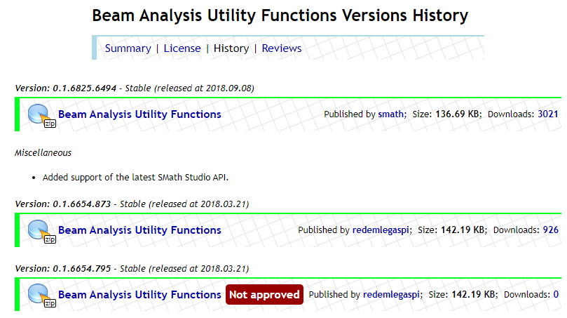

#16 Posted: 1/27/2020 8:49:15 AM
1,558 likes in 1,868 posts.
I'm going to try to find the sources you asked for, mailing Redem Legaspi. Any specific file or extension?
Redem Legaspi can ask Anrey how to upload sources to svn. After that we'll can maintain his project without author.
As far as I can see, the last update was made by Andrey. Maybe he has sources.

#19 Posted: 2/5/2020 4:11:36 AM
2,345 likes in 4,059 posts.
Hello.
Sources of Beam Analysis Utility Functions stored on SMath server but author of a plug-in asked not to share them.
Several days ago I've got permissions to fix an issue.
Plug-in functionality restored now. Tested ok with all available sample worksheets.
New version of a plug-in available using Extensions Manager.
3 users liked this post
Вячеслав Мезенцев 2/5/2020 5:17:00 AM, sergio 2/5/2020 5:33:00 AM, Martin_B 2/5/2020 7:10:00 AM
