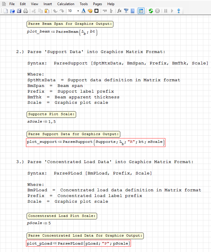

I'm trying to use the Structural Beam Analysis plugin, but I've got some problems.
When I open the “Beam Analysis” example I've got the next problem.
The error says "Indice fuera de los limites de la matriz" (Index outside matrix boundaries)
Could somebody help me with that?
Thanks in advance

I've got the problema with the example that's why I didn't send the file before.
You can find it attached.
Thanks

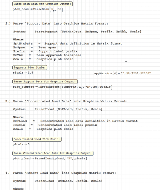

NOTE: Opened fine in 7251

The original file showed Red while opening, but finally opened successfully in SS 7251.
Then saved as with a new name, which opens later without any such hassle.

I confirm the problem highlighted by Eneko also on my pc with win7 Pro and SM SM "0.99.7251.32800".
The only dependency reported in the guide is the plugin "Structural Beam Analysis
Utility Functions by Redem Legaspi Jr." that is set up and active.

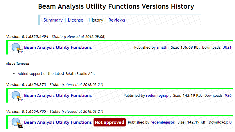

#16 Опубликовано: 27.01.2020 08:49:15
I'm going to try to find the sources you asked for, mailing Redem Legaspi. Any specific file or extension?
Redem Legaspi can ask Anrey how to upload sources to svn. After that we'll can maintain his project without author.
As far as I can see, the last update was made by Andrey. Maybe he has sources.

Группа: Super Administrator
Hello.
Sources of Beam Analysis Utility Functions stored on SMath server but author of a plug-in asked not to share them.
Several days ago I've got permissions to fix an issue.
Plug-in functionality restored now. Tested ok with all available sample worksheets.
New version of a plug-in available using Extensions Manager.
