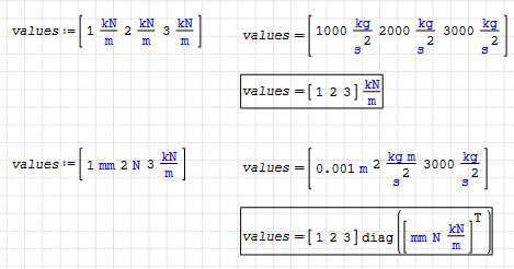

Hi
I have a dataset (using Excel-file as a source) from where I get values with vlookup, but I am unable to set units properly.
Values retrieved from a matrix have these square brackets around them [], and it makes working with units really difficult.
I was able to convert mm to m (my database has plain values, but they are supposed to be mm). But next step is to display final results in kN/m, but I keep getting kg/s^2.
I am able to remove units completely and display the correct result without units displayed, but this is suboptimal.
EDIT: I'm using importData plugin

#4 Posted: 6/11/2023 3:32:41 PM
1,123 likes in 1,795 posts.
... I was able to convert mm to m (my database has plain values, but they are supposed to be mm). But next step is to display final results in kN/m, but I keep getting kg/s^2. ...
Hi. Something like this?

#6 Posted: 6/11/2023 6:35:16 PM
598 likes in 1,380 posts.
My guess is his data is something like this.
That's what I deduce from his description at least.
Without him posting datasheet we can't help any further.

Thanks for your replies, here are the files.
I would like to display variable z as kN/m instead of that kg/s^2
#8 Posted: 6/12/2023 5:29:17 AM
1,443 likes in 2,935 posts.
You have to customize the result units in the rightmost placeholder.
sergio 6/12/2023 5:44:00 AM
Thank you! I don't know how I didn't get that working couple days ago, I tried to write units outside of brackets but didn't succeed. But now it works no problem
