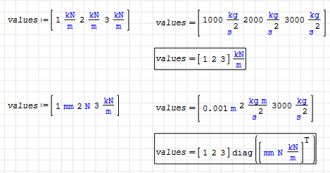

I have a dataset (using Excel-file as a source) from where I get values with vlookup, but I am unable to set units properly.
Values retrieved from a matrix have these square brackets around them [], and it makes working with units really difficult.
I was able to convert mm to m (my database has plain values, but they are supposed to be mm). But next step is to display final results in kN/m, but I keep getting kg/s^2.
I am able to remove units completely and display the correct result without units displayed, but this is suboptimal.
EDIT: I'm using importData plugin

... I was able to convert mm to m (my database has plain values, but they are supposed to be mm). But next step is to display final results in kN/m, but I keep getting kg/s^2. ...
Hi. Something like this?

My guess is his data is something like this.
That's what I deduce from his description at least.
Without him posting datasheet we can't help any further.

Thanks for your replies, here are the files.
I would like to display variable z as kN/m instead of that kg/s^2
#8 Опубликовано: 12.06.2023 05:29:17
You have to customize the result units in the rightmost placeholder.
Thank you! I don't know how I didn't get that working couple days ago, I tried to write units outside of brackets but didn't succeed. But now it works no problem
