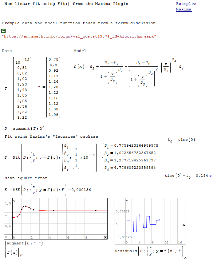

Example application for Fit(), MSE() and Residuals() and efficient plotting.
Example Fit.sm (13.62 KiB) downloaded 1691 time(s).
3 users liked this post
Radovan Omorjan 9/22/2018 3:02:00 AM, Вячеслав Мезенцев 9/22/2018 2:15:00 AM, frapuano 9/22/2018 8:26:00 AM
#251 Posted: 9/22/2018 3:36:05 AM
Thank you Martin,
I tested it briefly with a larger data set and more than one dependent variable. At a first glance it seems that it works surprisingly fast. I might have forgotten but I think there is not yet a strictly numerical procedure in SMath (available via plugin) for nonlinear fitting a quite large data set to a function with multiple dependent variables.

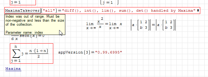

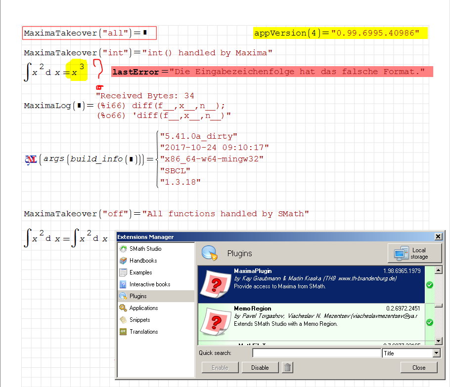

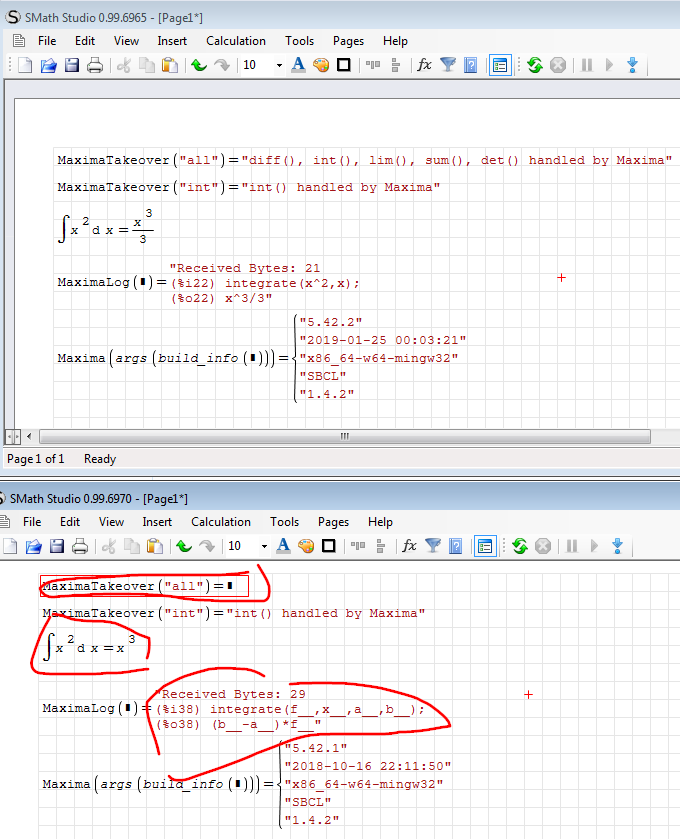

#253 Posted: 2/25/2019 8:00:58 PM
1,361 likes in 2,275 posts.
Severe problems since SMath build 6970. Last version tested ok is 6965.
maximaproblem.sm (4.28 KiB) downloaded 1690 time(s).
#254 Posted: 2/26/2019 4:03:40 AM
Confirmed, I think...

Hello SMath-Team,
I confirmed, it confuses me too
Best regards,
Andrey

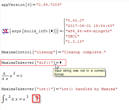

#256 Posted: 3/6/2019 4:29:41 AM
The problem remained unsolved
However, it seems that Det(),Diff(),Int(),Lim(),Sum() are working well.
#257 Posted: 3/6/2019 10:27:27 AM
Int() certainly does not work.
Why bother Maxima, unless some like that cluster fuck
#258 Posted: 3/6/2019 12:35:51 PM
2,343 likes in 4,056 posts.
Plugin updated. Please try.
Martin Kraska 3/6/2019 3:41:00 PM, frapuano 3/6/2019 5:28:00 PM
#259 Posted: 3/6/2019 3:14:38 PM
I think it is all right now. Thank you.
#260 Posted: 3/6/2019 3:40:46 PM
I confirm that the API issues seem to be resolved. Andrey, thank you very much, I might not have been able to fix that soon.
In the test suite (Plugin maxima test.sm in the interactive handbook) there is just a new issue with displaying svg images in the Maxima-Draw-Region and in the image region. PDF and PNG work fine though.
Best regards, Martin
