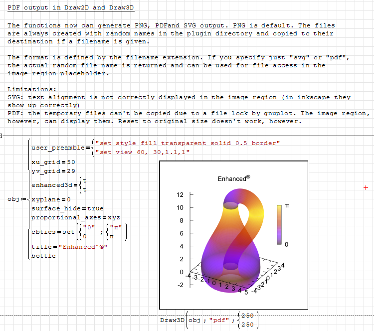

#227 Posted: 8/13/2017 6:23:41 PM
1,361 likes in 2,275 posts.
New pre-release of the plugin. Changes with respect to the version in the online gallery:
- SS-1244/SS-2401: Takeover of SMath functions int(), diff(), det(), sum(), lim()
fixed and now on per-document base instead of per-session base.
- SS 193: MaximaDefine() now does not add SMath definitions
- SS 191: Access to last result with Maxima(%) works
- SS 189: Waiting for Maxima response now without time-out
- MaximaLog(): Improved formatting
- Compatibility with Maxima 5.40.0 (SBCL recommended)
- Icon for the Insert> Maxima Menu group
- Unicode support
- Draw2D/3D: PDF output support
Due to severe limitations of the current SMath beta (importData() not working) I shall focus on retrofitting the plugin version for the current stable SMath release 0.98.6179.
MaximaPlugin.zip (66.94 KiB) downloaded 581 time(s).
Update16pre2.sm (50.81 KiB) downloaded 1679 time(s).

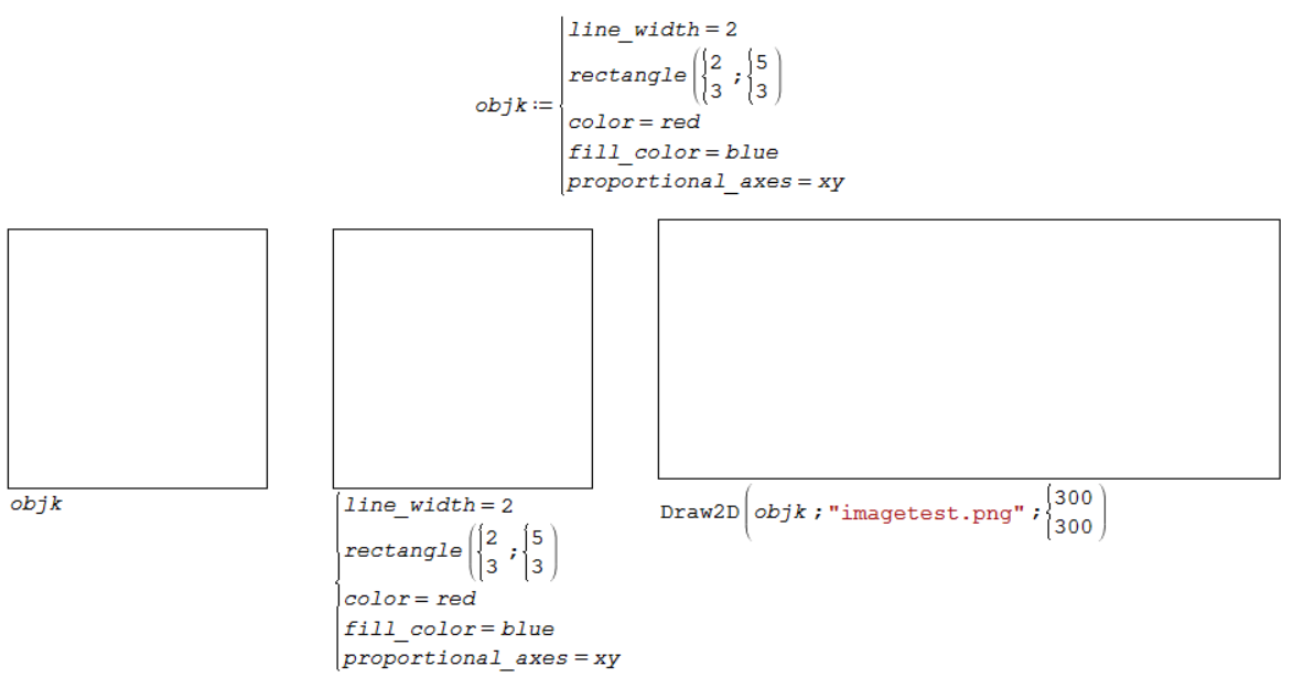

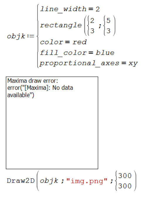

Hi!
I'm new to SMath and just started with Maxima. I'm more interested in its drawing functions.
I downloaded version 5.38.1 and set the path. It starts correctly, but drawing commands keep not working.
For example:
And the log shows:
draw2d([background_color="#fefefe",file_name="C:/Users/João Felipe/AppData/Roaming/SMath/extensions/plugins/44011c1e-5d0d-4533-8e68-e32b5badce41/GnuPlot/ieaglqnv",terminal=png,user_preamble=["set term pngcairo font ',8' enhanced size 300,300","set encoding utf8"],line_width=2,rectangle([2,3],[5,3]),color=red,fill_color=blue,proportional_axes=xy]);draw2d(terminal=pngcairo, file_name="C:/Users/João Felipe/AppData/Roaming/SMath/extensions/plugins/44011c1e-5d0d-4533-8e68-e32b5badce41/GnuPlot/z4ujxmcs", dimensions=[250,250], font="Arial", font_size=8, title="SAMPLE PLOT", xu_grid=40, yv_grid=40, xlabel="x", ylabel="y", zlabel="z", yrange=[-5,5], zrange=[-5,5],user_preamble=["set term pngcairo font ',8' enhanced size 250, 250", "set encoding utf8", "set grid xtics mxtics"],explicit(sin(x),x,-5,5));
I would appreciate any help.
Thanks in advance!
#233 Posted: 2/22/2018 12:47:22 PM
There are two ways to display Maxima graphics.
1. Use a dedicated interactive Draw region (Insert> Maxima> Draw2D()/Draw3D()) and write the list of draw objects and settings to the placeholder.
2. Use an image region (Insert> Image) and write a Draw2D/3D function with appropriate arguments to the placeholder. These functions generate graphics files and return the name of the file. This is what Image region needs to display the image.
You mixed both approaches. Thus either put objk in the placeholder of the maxima region or put the full Draw2D command in the placeholder of an image region.
I didn't test 5.38.1 with the current plugin version (don't know if that Maxima is unicode-proof). I recommend 5.41.0.

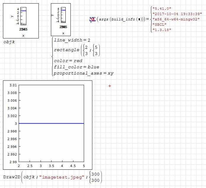

#234 Posted: 2/22/2018 1:04:32 PM
João Felipe Seráfico Melo
7 likes in 62 posts.

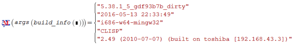

#235 Posted: 2/22/2018 1:10:16 PM
please attach your sm file and give the output of Maxima(args(build_info(#)))
#237 Posted: 2/22/2018 1:24:03 PM
.sm file: testing_drawing2d.sm (14.53 KiB) downloaded 1674 time(s).
#238 Posted: 2/22/2018 1:33:52 PM
Works for me. Not really exciting because the rectangle is just a horizontal line but works.
Your maxima is outdated and not set to steel bank common lisp (SBCL). If you really need to work with old maxima, then you might try the 2014 version of my portable distribution, follow the link in my signature.

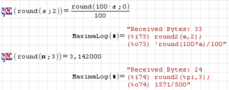

#239 Posted: 4/5/2018 12:31:33 PM
Plugin updated.
Changes:
SS-3457 Translation of round(2)
Fix of description strings for MaximaTakeover(), Draw2D() and Draw3D()

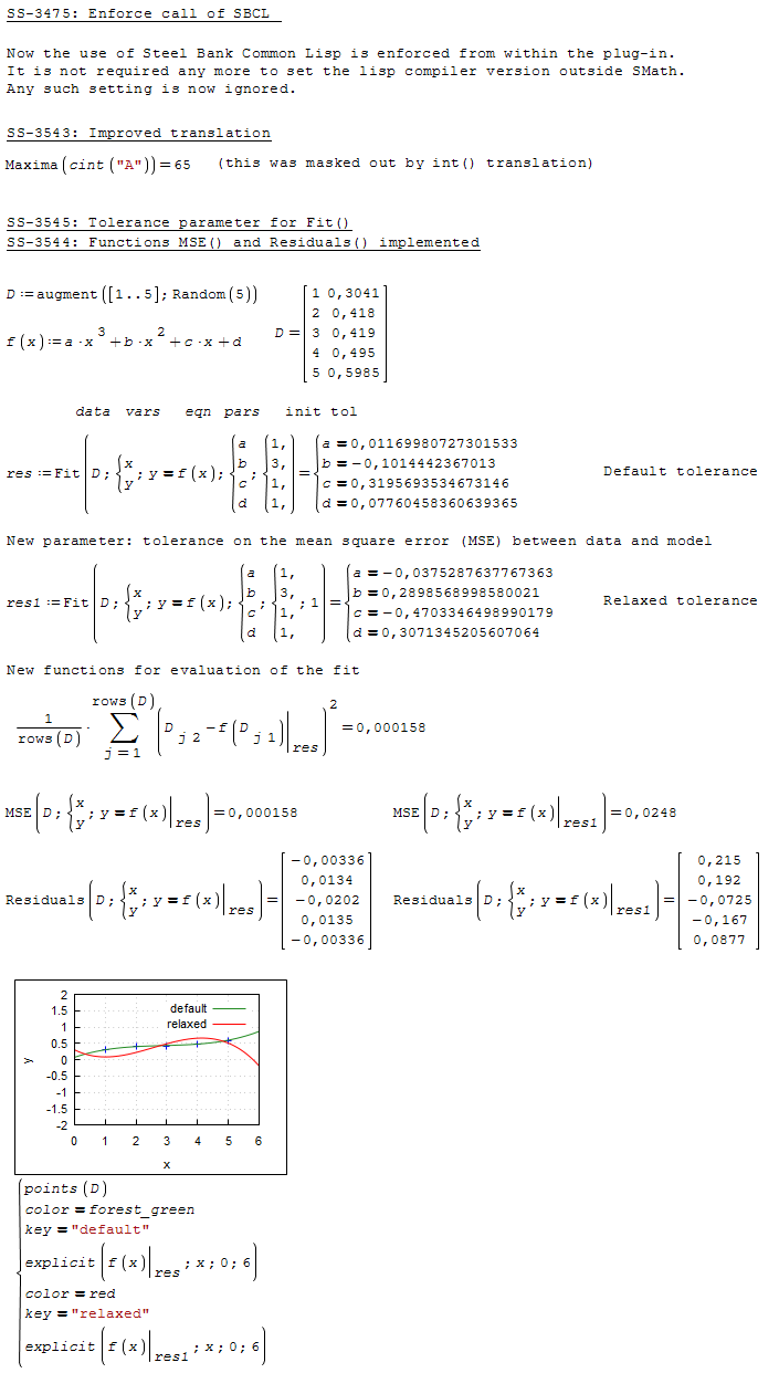

#240 Posted: 9/7/2018 7:48:40 PM
Plugin updated (for SMath 6671 stable and 6824 beta).
Update18.sm (29.51 KiB) downloaded 1652 time(s).
