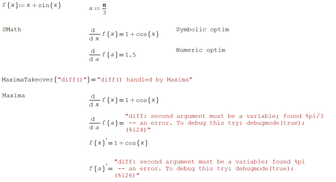

Hi. Can the Maxima plugin beheavior could be changed to agree with SMath (and Mathcad) diff operator, when the variable is defined?:
MaximaDiff.sm (6.87 KiB) downloaded 1701 time(s).
Thanks in advance for your answer.
This would require access to the unevaluated (non-preprocessed) verbatim expression from within the plugin. I don't know if that is currently possible. Same problem applies for definite integrals for numeric evaluation. I could take over numeric quadrature as well if I had access to the unevaluated expression.
Perhaps our other developers have a quick anwer?

Hi Martin. I see the request SS-3478. But I guess that this isn't related with the noun Maxima's property (x::uneval in maple, and Hold[] in Mathematica. Actually I ask some time ago something like this related with derivatives of cool prop package).
I guess that defining
bool IPluginLowLevelEvaluation.ExpressionEvaluation(Term root, Term[][] args, ref Store context, ref Term[] result)
where the difference with normal call is ref Store context, and then
termVar = SMath.Math.Computation.Preprocessing(termVar, ref context);
you can handle the case where an argument is defined, catching the variable name, and trying to determine if it is defined or not.
Actually I paste both of them from Maxima plugin source code. (But the second is commented).

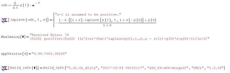

Hi. There are some issue here:
The problem seems to be the pre-mature execution of at() on SMath side. You see that if you switch off the Custom Functions plugin, then the answer is correctly displayed. Thus it isn't a translation issue. It would be desirable to keep the unevaluated response at least if optimization is set to "none".
I need to see if the Maxima plugin can do anything about it or even is the culprit.
Thank you for pointing this out. Filed as SS-4597.

Hi Martin. Thanks. Here, exp instead e^ seems to avoid this issue.
