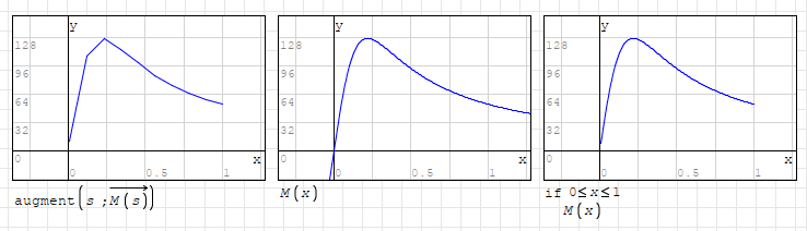

If you just wrote M(s) then your plot doesn't have enough points.
Both x and y points should be written if you are plotting them.
You can achieve this by augmenting x and y points.
Or you can plot directly by M(x) which plot region will use x for x values.
Result of your M() function will be used for y values.
You can limit plotting by simple if() or cases() function.
1.sm (15.43 KiB) downloaded 1318 time(s).

You can combine your functions by using sys().
Here is you plot completed.

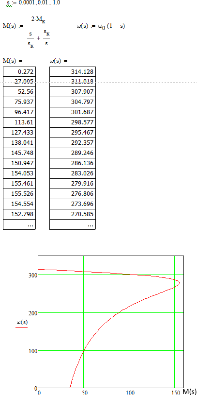

And I have mathcad example:
Meh_Har_AD.xmcd (81.1 KiB) downloaded 1318 time(s).

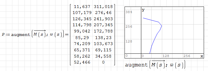

TopUser2000 2/15/2023 4:33:00 AM

Oh, thanks friend). That's what I need.
can someone explain to me why I have to use a vector quantity when outputting the value of M(s)? Otherwise, Smath complains about a non-square matrix.

The vectorize function enforces elementwise operation if vector valued variables are involved.
The linear operation defining omega is elementwise by default, whereas dividing by s would be understood as a matrix operation (inversion) by default.

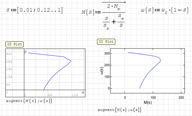

I tried to install this plugin, but I still didn't figure out how to rename the axes
Double click to XY Plot canvas, it will open a new window for you to change its setting.
You can also Right click>Format to plot area, it will do the same as double clicking.
There you can find a section Labels. Change x-y labels to M(s) and ω(s).
XY Plot contains a lot of options there. Check them and try them.
1.sm (16.51 KiB) downloaded 1318 time(s).

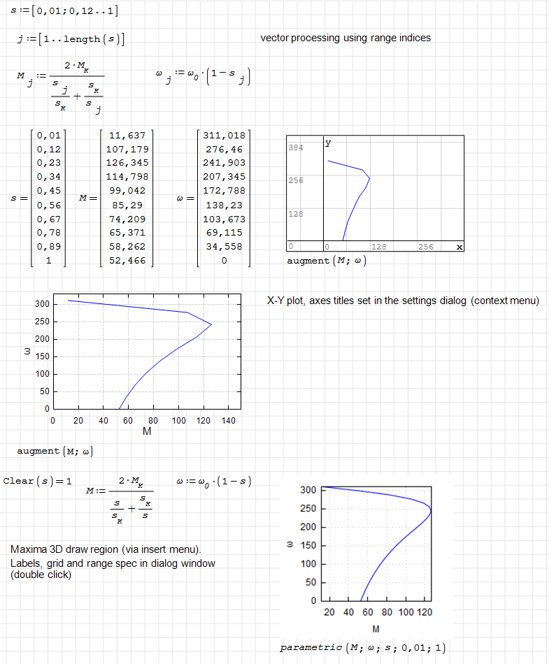

Vectorize-free versions, one with range indices and one with parametric plot.
1_Kr.sm (30.92 KiB) downloaded 1288 time(s).
