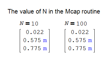

1. It only takes a couple of minutes on my laptop (which is far from a top of the range computer).
2. I notice that if you reduce the value of N (in routine Mcap) to 10 rather than 100, you get the same result (at least, for the default values of phi etc), and it runs quicker.
" border="0" />

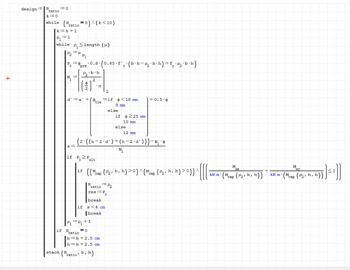

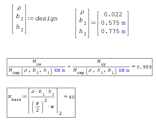

3. The following is a little more efficient at the end.
" border="0" />3. The following is a little more efficient at the end.

The attached runs twice as fast as the original for the same data. I've also set the value of N in routine Mcap() to 10 rather than 100 (in the original as well) because the results are the same. This leads to a ten-fold increase in speed of course. With N = 100 the original file takes just over 200 seconds on my laptop, the attached takes just over 100 seconds.
If your 30 minute time referred to the other file you uploaded, then that doesn't run at all on my laptop because of missing data -see the comments in my first post above.
