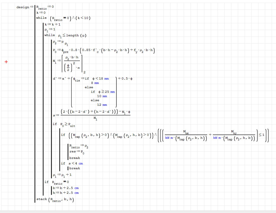

You have a number of problems:
1. f'c is undefined.
2. Phi_tie needs to be a function of phi: Phi_tie(phi) = etc.
3. You can't use text and numbers together in numerical calculations. For example, when calling Phi you need subscripts to represent the row and 2nd column to extract the numerical value.
4. In your functions Mcap etc you should pass them a specific value of phi (and then same for any other vectors) rather than the whole vector.
Fix the above and see if there's any improvement.

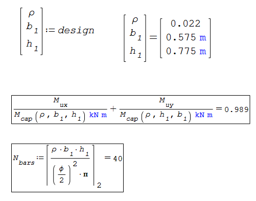

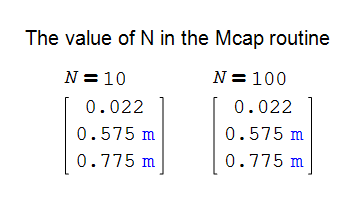

2. I notice that if you reduce the value of N (in routine Mcap) to 10 rather than 100, you get the same result (at least, for the default values of phi etc), and it runs quicker.
" border="0" />
3. The following is a little more efficient at the end.
1. It only takes a couple of minutes on my laptop (which is far from a top of the range computer).
" border="0" />3. The following is a little more efficient at the end.

change the input data (h = 50 cm, b = 50 cm) at the beginning of the page so that he can discover problemWroteI've had a quick look at your other file.
2. I notice that if you reduce the value of N (in routine Mcap) to 10 rather than 100, you get the same result (at least, for the default values of phi etc), and it runs quicker." border="0" />
The attached runs twice as fast as the original for the same data. I've also set the value of N in routine Mcap() to 10 rather than 100 (in the original as well) because the results are the same. This leads to a ten-fold increase in speed of course. With N = 100 the original file takes just over 200 seconds on my laptop, the attached takes just over 100 seconds.
