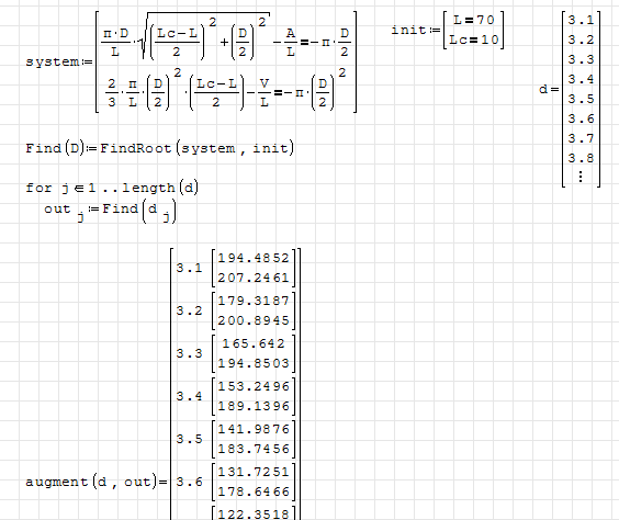

#2 Posted: 6/1/2017 12:15:32 PM
I guess is not possible (?) with current version, one reason (but not the only) is because embedded assignments.
Will works with the refactored version, though.
Radovan Omorjan 6/1/2017 2:01:00 PM
#3 Posted: 6/1/2017 2:54:16 PM
Thanks Davide,
In the mean time: I did, a bit differently.
Next => collect for the plot.
