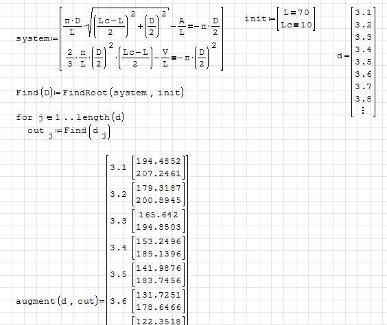

#1 Опубликовано: 01.06.2017 11:19:06
This solve block does not accept iterative scan.
Can't make it work YET ! for multiple solutions.
Who is the pest: the solve block or Jean.
Wecome on this one ... Jean
Solve GivenFind Iterate.sm (10,98 КиБ) скачан 1205 раз(а).
Radovan Omorjan 01.06.2017 14:00:00
#2 Опубликовано: 01.06.2017 12:15:32
I guess is not possible (?) with current version, one reason (but not the only) is because embedded assignments.
Will works with the refactored version, though.
Radovan Omorjan 01.06.2017 14:01:00
#3 Опубликовано: 01.06.2017 14:54:16
Thanks Davide,
In the mean time: I did, a bit differently.
Next => collect for the plot.
