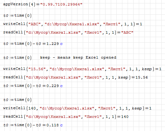

You can try this version. Just replace the ExcelIOCom.dll file.
ExcelIOCom.7109.zip (9.41 KiB) downloaded 282 time(s).
EDIT. I added this plugin to the gallery. Previously, it was not there, because it is very old. Unfortunately, this plugin will not work in Linux, as based on COM.
