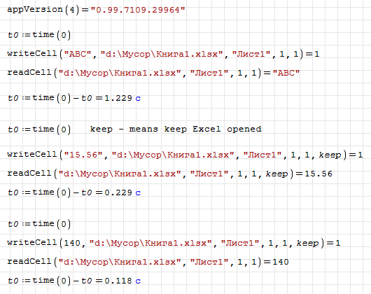

I don't think this plugin is still actively maintained. It may not work with recent versions of SMath.
You can try this version. Just replace the ExcelIOCom.dll file.
ExcelIOCom.7109.zip (9,41 КиБ) скачан 333 раз(а).
EDIT. I added this plugin to the gallery. Previously, it was not there, because it is very old. Unfortunately, this plugin will not work in Linux, as based on COM.
I made a mistake in the type of plugin. Now I understood what was meant. I will try to update this plugin as well.
