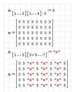

- SS-3513: It is allowed now to use vector-based expressions as indexes for matrix definition;

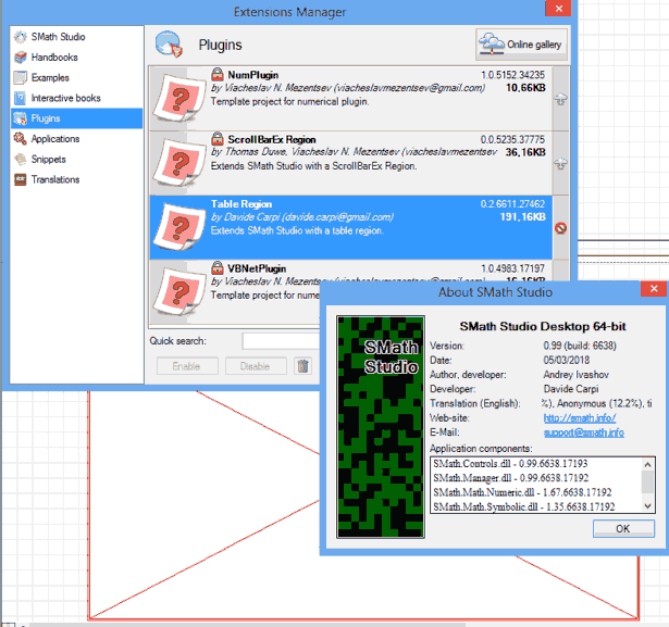

Fixed (please update a plug-in). Thank you!

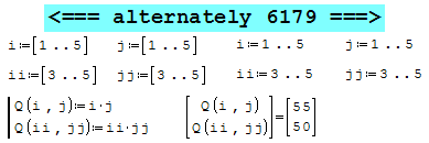

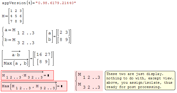

WroteA bug in functionality of vectorize() was introduced between 0.99.6617 and 0.99.6638
That it was introduced between 6617 & 6638, that is surprising ?
Even if it did work, to me, it is not correct because it will cause
something wrong sooner or later, because to reflexive in the
calculation kernel ... Murphy's law. I have experimented disastrous
situations [crash ... push the button to stop].
Occasionally, to isolate, you have to spool to file.
Cheers Alex ... Jean
WroteA bug in functionality of vectorize() was introduced between 0.99.6617 and 0.99.6638. Will this be addressed?
Jean are right, this didn't work initially, but started working at some point because of another bug
I've investigated this example and was able to make it work together with all other examples I have about vectorize(..) function. All tests executed OK.
