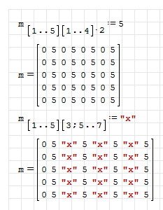

#2 Опубликовано: 05.03.2018 16:01:34
For those interested to test useful functionalities 6638
Utilities Matrix_Vector [MCD 4 styles].sm (34,65 КиБ) скачан 1527 раз(а).

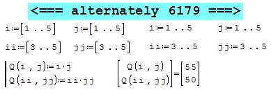

#3 Опубликовано: 05.03.2018 16:17:36
Observe ... Q(i,j) is already code "trace"

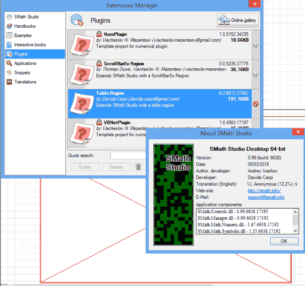

CBG
CBG
Every time Smath Studio is updated, something goes wrong. Again failed
to start the plugin Table Region, Smath Studio does not recognize it.
#5 Опубликовано: 05.03.2018 18:25:50
Группа: Super Administrator
Carlos,
Yeah, its a life...
Fixed (please update a plug-in). Thank you!

#7 Опубликовано: 05.03.2018 22:23:16
That's why I'm 6179 for productive projects.

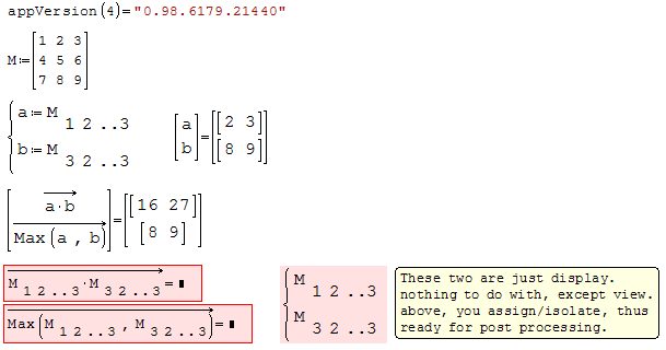

#13 Опубликовано: 14.03.2018 18:46:18
Alexander O. Melnik
Alexander O. Melnik
A bug in functionality of vectorize() was introduced between 0.99.6617 and 0.99.6638. Will this be addressed?
#14 Опубликовано: 15.03.2018 01:09:35
That it was introduced between 6617 & 6638, that is surprising ?
Even if it did work, to me, it is not correct because it will cause
something wrong sooner or later, because to reflexive in the
calculation kernel ... Murphy's law. I have experimented disastrous
situations [crash ... push the button to stop].
Occasionally, to isolate, you have to spool to file.
Cheers Alex ... Jean
#15 Опубликовано: 15.03.2018 14:12:50
Jean are right, this didn't work initially, but started working at some point because of another bug Yes, I'm not kidding.
I've investigated this example and was able to make it work together with all other examples I have about vectorize(..) function. All tests executed OK.
So, I decided to include this improvement into new release: https://en.smath.info/forum/yaf_postst12594_RC-0-99-6648--15-March-2018.aspx
Please test examples you have with vectorize(..) function.
