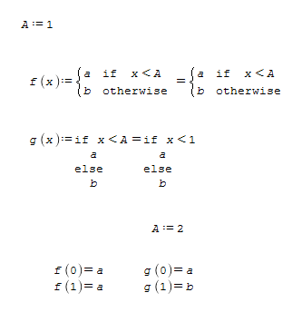

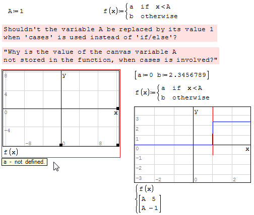

Shouldn't the variable A be replaced by its value 1 when 'cases' is used instead of 'if/else'?

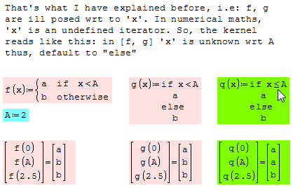

Whatever is behind the scene, your project is ill posed..
Conditional statements must be intelligible for the numerical maths.

I really don't want to play silly games with you anymore.
I asked a simple question: "Why is the value of the canvas variable A not stored in the function, when cases is involved?"
Your answer has absolutely nothing to do with my question.
I have attended another screenshot to show the consequences of not storing the value.
cases behaves, as if there where a line operator.

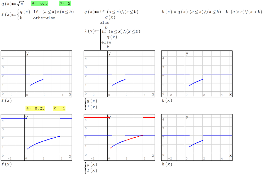

I notice one instance if/otherwise does not work vs if/else.
Reported, not acknowledged ... maybe more than one instance.
#5 Posted: 4/30/2018 10:17:16 AM
... generally, if/else is more convenient in program.
Utilities Matrix Exclude Region.sm (35.43 KiB) downloaded 1177 time(s).
Davide can answer this for certain. However, I would imagine that it should not. Since cases() function is kind of like a wrapper for nested if() statements, I imagine that it stays completely symbolic until evaluated numerically.
This is just a guess. Otherwise I would imagine that when you evaluated a cases() statement symbolically you would see the nested if() instead.

... However, I would imagine that it should not. Since cases() function is kind of like a wrapper for nested if() statements, I imagine that it stays completely symbolic until evaluated numerically.
The two expressions in the screenshot in my first post are evaluated symbolically.
I think I can remember that in the past when "hovering the mouse" it was was dissolved in a chain (product) of boolean expressions, without using if/else.
Yes, It looks like that may have changed about two years ago according to this post: https://en.smath.info/forum/yaf_postsm35489_Custom-Functions-plugin.aspx#post35489
Which leads me to believe the cases() functions worked different depending on the optimization.

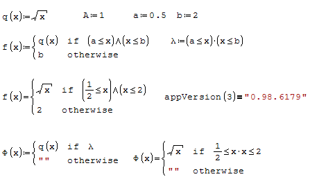

#12 Posted: 4/30/2018 5:05:02 PM
Can't be evaluated otherwise => nothing is defined/assigned,
thus literal evaluation ... try this
Maybe you missed my other point about appropriate condition [De Boor]
You have that in much simpler instances, not visible and falsifying project.

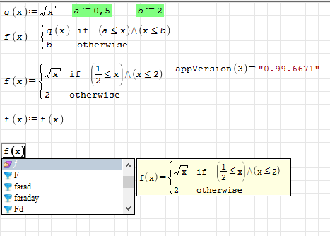

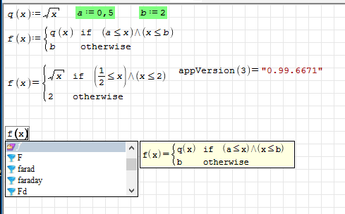

The values of a, b and q(x) are not stored in f, as you can see in the following screenshot.
And by assigning f to f they are!
And that seems to me like a kind of invisible line operator, because it behaves like one.

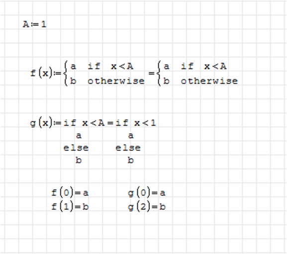

I do not understand. The cases function works perfectly.
cases_ok.sm (4.6 KiB) downloaded 1167 time(s).

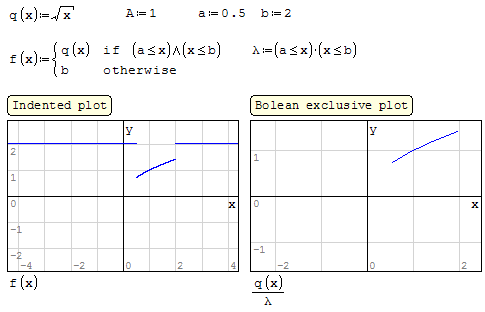

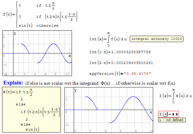

The all thing is about what comes from conditional.
For instance: the integration operator needs an analytical integrand.
From if/else, integrand is not scalar vs if/Otherwise.
Simple things turn nightmare ... many same in Mathcad.
Plots are same but not integration.
#17 Posted: 4/30/2018 8:14:58 PM
... for this particular integration example, it is necessary and sufficeinet
to transform the domain of if/else [ infinitesimal ...] in scalar domain.
Here, we have it already done in term of integration.
Integrate Discontinuous [Nuance].sm (13.02 KiB) downloaded 1007 time(s).
The difference comes when the value of A changes after the definition of f(x) and g(x).
For g(x) the original definition of A:=1 remains. However, for f(x) the value of A changes.
cases_ok_alyles.sm (5.57 KiB) downloaded 1144 time(s).
