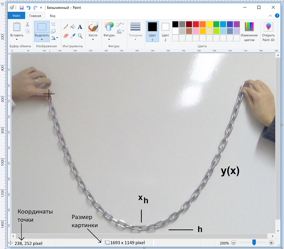

How to use here the al_nl plugin?
Catenary-Photo-an_nl.sm (1.2 MiB) downloaded 1581 time(s).

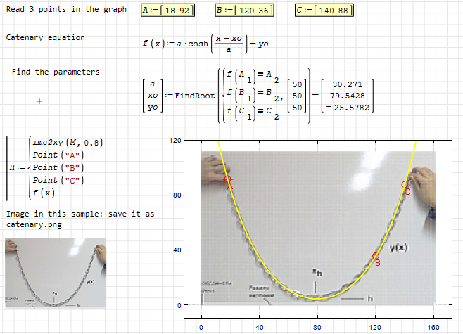

Hi Valery. You can try this.
img2xy-catenary.sm (2.19 MiB) downloaded 1552 time(s).

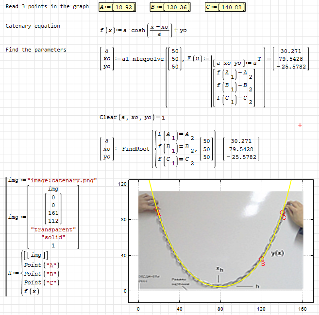

Hi. Using the new functionality of XYPlot:
Image with size 161x112:
Smath file: img-catenary-al_nleqsolve.sm (19.15 KiB) downloaded 1427 time(s).
ioan92 9/27/2024 2:31:00 PM
