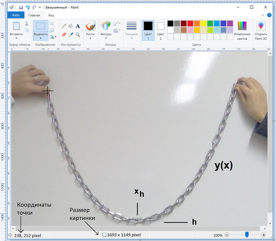

How to use here the al_nl plugin?
Catenary-Photo-an_nl.sm (1,2 МиБ) скачан 1659 раз(а).

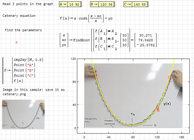

Hi Valery. You can try this.
img2xy-catenary.sm (2,19 МиБ) скачан 1638 раз(а).

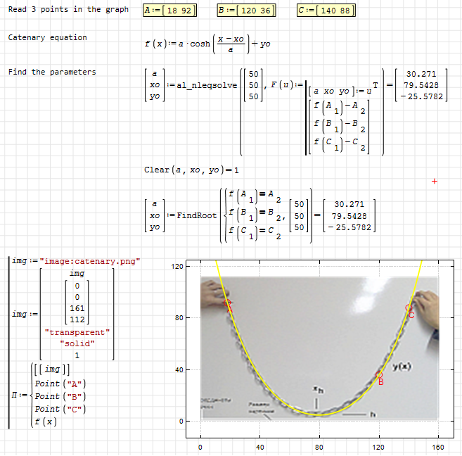

... the question was not about y(X), but al_nl****
Hi. Using the new functionality of XYPlot:
Image with size 161x112:
Smath file: img-catenary-al_nleqsolve.sm (19,15 КиБ) скачан 1492 раз(а).
