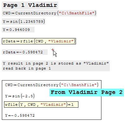

#3 Posted: 4/25/2016 10:58:34 AM
Reword: Can we change variable determined on first sheet from variable from last sheet?
VladimiR,
Not very clear: as you open Smath you have page 1 [that you name as you wish]
When you call "New page" you will have page 2 [that you name as you wish]
... and so on ...
If page 1 collects successively results from page 2,3,,,
in page 2 write to file the calculated Y
read back [rfile] in page 1 the last calculated value from page 2
In other words: each time you update Y in pages 2,3,,, and [writefile]
in page 2,3,,, it updates the Y stored in file that you read back in page 1.
At the top of each page [work sheet] re-identify for the same file directory.
