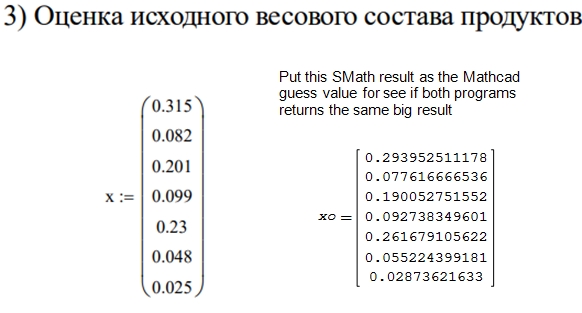

Maybe I don't explain well: try to check what happen with mathcad if you use the SMath answer as the guess, this is substitute the x value in Mathcad for the xo value from SMath here:
But actually that's for compare. SMath solution checks all the constraints, then it's a candidate for the problem solution. You "didn't get close result", but I don't see a problem there, where I see a problem is if you want a close result, this is a result near to 8.8*10^8 you need to review your physical system and check if there are some additional constrictions for some variable or function which make your result "close" to that value. If not, SMath solution it's just a good solution, and Mathcad's isn't.
