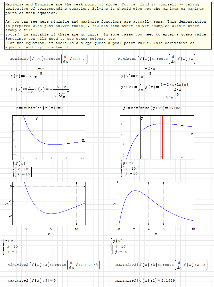

You can write your own functions.
maximize and minimize are peak points of slope.
Take derivative of equation, solve it.
Check the examples below.
maximize_minimize.sm (16.48 KiB) downloaded 1232 time(s).
maximize_minimize with different solvers.sm (28.5 KiB) downloaded 1234 time(s).

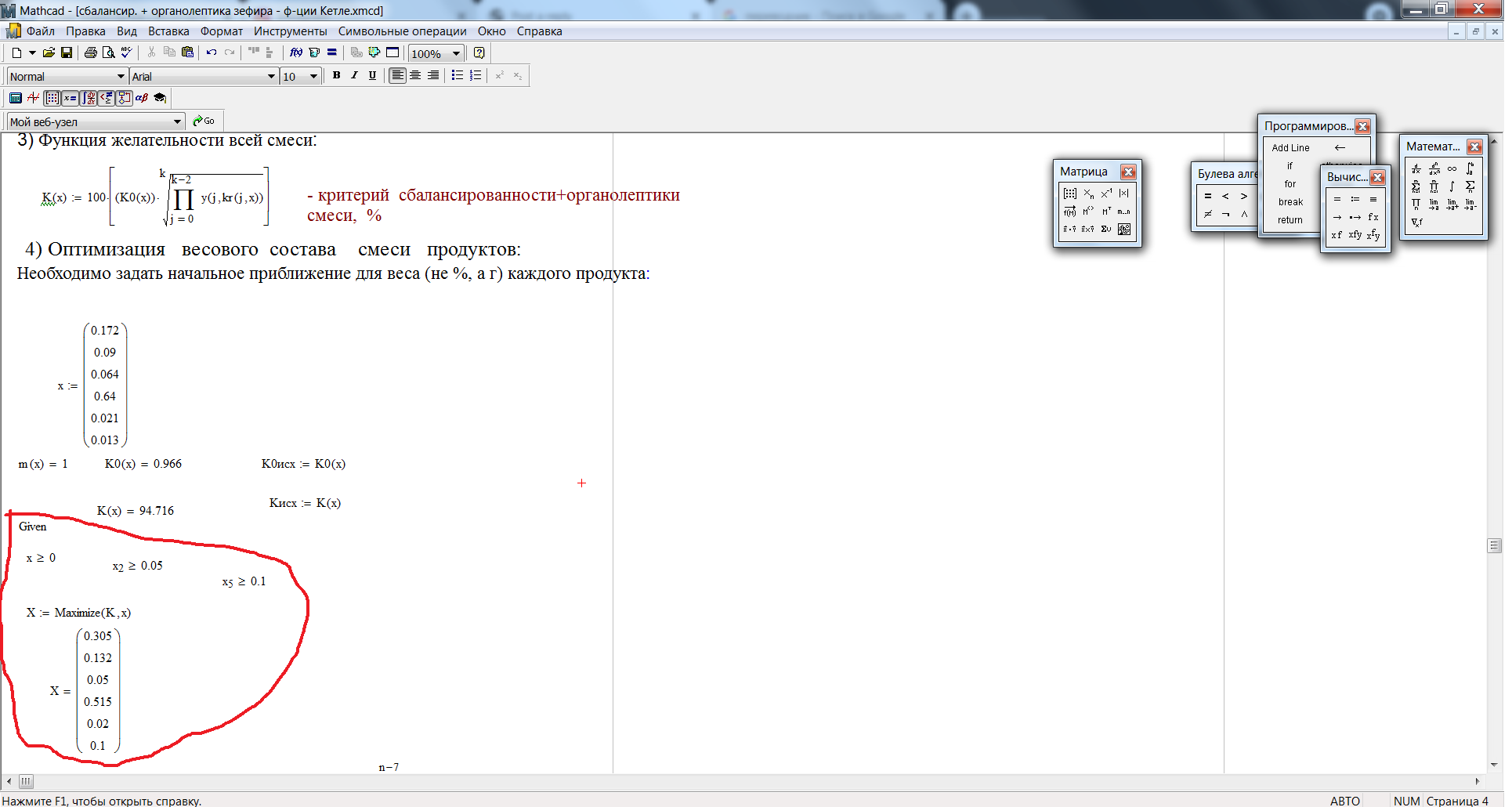

I have a program in MathCad,the problem is that the marshmallow recipe is being optimized here,
I need a maximization function to find the maximum value of each ingredient.
sbalansir. + organoleptika zefira - f-cii Ketle.xls (21 KiB) downloaded 868 time(s).
the exel file contains the values ​​of each marshmallow component that are used in the task.
sbalansir. + organoleptika zefira - f-cii Ketle.xmcd (250.52 KiB) downloaded 1298 time(s).
The whole problem is that the function K(x) is six-dimensional and there is no idea how to find its derivatives.
I need to do the same in Smath Studio, but there are no Given / Maximize / Minimize functions in Smath,
I don't know how to implement this.

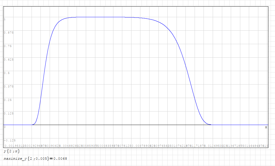

Here is the first solution for your graphics. Rest are in the example.
This is an ugly and fast solution compiled in a haste.
I am pretty sure someone in the forum will come with a more classy method.
diplomnayaRabota_rev.sm (40.34 KiB) downloaded 1201 time(s).

Thanks for your feedback , but I need to calculate maximize from the function K(x),
not from y(j, x).
Check this pdf Mathcad file:
Mathcad - sbalansir. + organoleptika zefira - f-cii Ketle.pdf (245.08 KiB) downloaded 746 time(s).
After the function K (x), the vector x is given as the initial approximation
and after that the Given and Miximize functions are used for the K(x) function.
I need to get vector X in Smath.
p.s sorry for my bad eng

The Mathcad's screenshots are perfect. Here you have a little difference: the restrictions involving another function Kc(x), but it's very similar, and need to write CheckX for x and CheckKc for Kc(x). The trick for CheckKc(x): No one, but three:
First, return some information to the solver about how the things are going. Instead of return 0 or 1, return 0 for Kc is in the good interval, and +/- normi(x) if not.
Second, include CheckKc(CheckX(x)) as second row in the target function for try to get zeros on both components.
Third, include CheckKc in the exit condition for the main loop.
Milk shake optimization nleqsol.sm (1.4 MiB) downloaded 1240 time(s).
