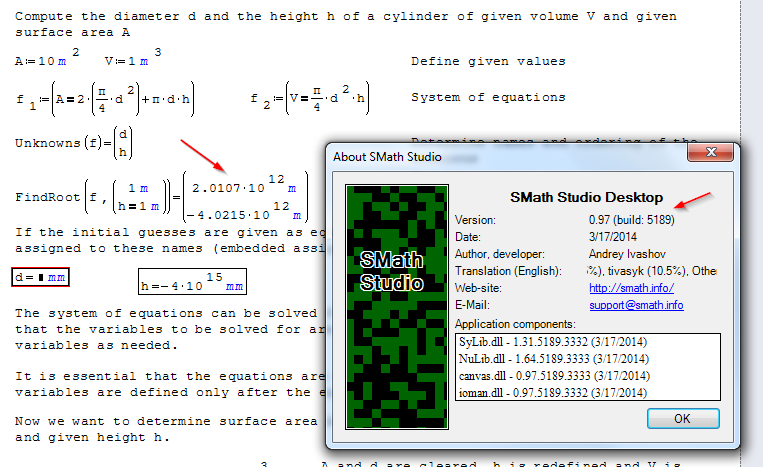

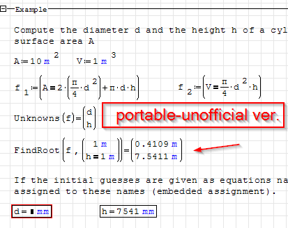

By the way Martin,
I might missed it, but I think there is still no answer about the differences between the official (wrong) and unofficial-portable (correct) and FindRoot() example

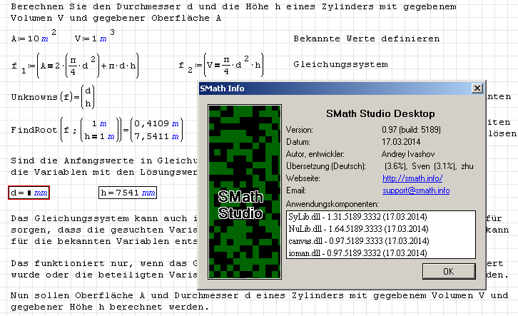

Can't reproduce this. Based on 0.97.5189 there is no difference between portable and non-portable version.

This is quite strange . Could someone else else try to reproduce this please.
This is only happening to me with the official (regular) install

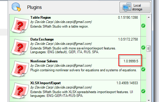

NS version is 1.0.9999.5 for both of you (Martin and Radovan)?
#8 Posted: 5/3/2014 10:24:19 AM
1,362 likes in 2,276 posts.
I confirm version 1.0.9999.5 according to plugin dir name. I also tried to change arg/dec sep settings to komma/period and get the same (correct) result.
Hello Davide,
I also confirm the plugin version - see the picture please.
BTW, this is the same on my both computers home-Win7 32bit, office-Win7 64bit
