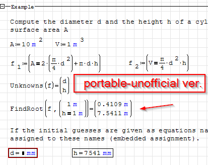

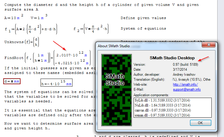

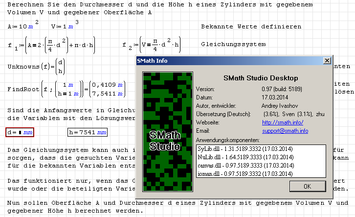

By the way Martin,
I might missed it, but I think there is still no answer about the differences between the official (wrong) and unofficial-portable (correct) and FindRoot() example
#5 Опубликовано: 03.05.2014 07:56:06
Can't reproduce this. Based on 0.97.5189 there is no difference between portable and non-portable version.
#6 Опубликовано: 03.05.2014 09:31:29
This is quite strange . Could someone else else try to reproduce this please.
This is only happening to me with the official (regular) install

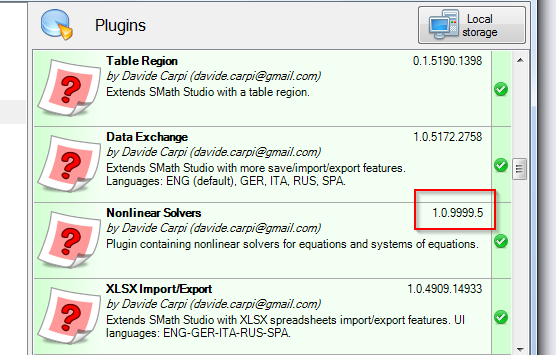

#7 Опубликовано: 03.05.2014 10:18:48
NS version is 1.0.9999.5 for both of you (Martin and Radovan)?
#8 Опубликовано: 03.05.2014 10:24:19
I confirm version 1.0.9999.5 according to plugin dir name. I also tried to change arg/dec sep settings to komma/period and get the same (correct) result.
Davide Carpi 03.05.2014 10:25:00
#9 Опубликовано: 03.05.2014 11:13:12
Hello Davide,
I also confirm the plugin version - see the picture please.
BTW, this is the same on my both computers home-Win7 32bit, office-Win7 64bit
