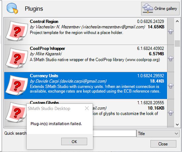

The latest MapleWrapper plugin fails to install.
Tried several clean installation of latest SS, but did not solve this problem.

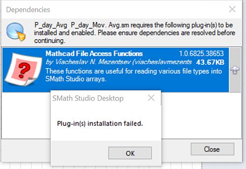

Hmm. I can't reproduce this issue.
#3 Posted: 9/21/2018 2:44:15 PM
NDTM Amarasekera
NDTM Amarasekera
130 likes in 352 posts.

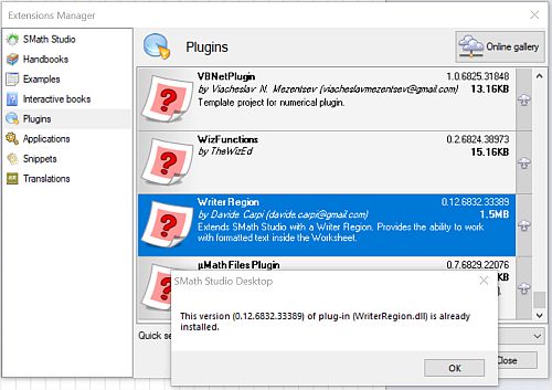

Again tried to install MapleWrapper, but same problem.
Then I get another problem with WriterRegion. Some link????
The only way for me was to do a clean re-installation without trying to install MapleWrapper, and then WriterRegion can be installed. Any attempt to install MapleWrapper will trigger the same problem with WriterRegion. I don't know why?

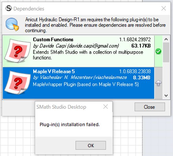

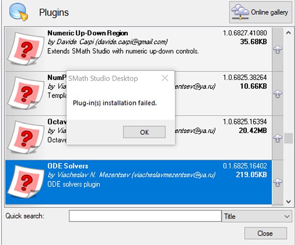

#10 Posted: 9/21/2018 4:52:56 PM
NDTM Amarasekera
NDTM Amarasekera
The MapleWrapper new build works now. But see the following. Very strange.
Cannot install TextRegionUtilities also, as indicated by Davide.

#11 Posted: 9/22/2018 12:23:47 PM
NDTM Amarasekera
NDTM Amarasekera
Attached file last opened and saved on 11/09/2018, but now
fails due to MathcadFileAccess plugin failing to install.
P_day_Avg & P_day_Mov. Avg.sm (37.44 KiB) downloaded 1206 time(s).

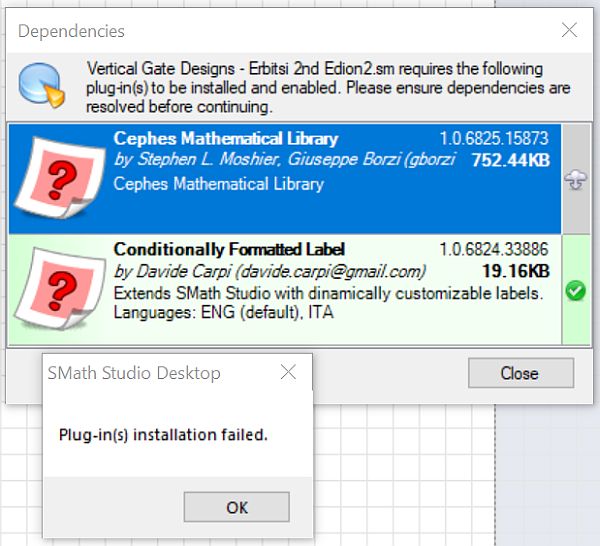

#17 Posted: 9/23/2018 4:37:55 AM
NDTM Amarasekera
NDTM Amarasekera
I think only Andrey can help here. Something wrong with your environment.
I believe the reason for failure to install plug-in(s) was an Antivirus Program (NOT Kaspersky).
After successfully installing latest SS "0.99.6839.38235" with necessay plug-in(s), problems cropped up again with CephesMathematicalLibrary, MapleWrapper, ODESolvers and a few.
I had to struggle to configure the Antivirus package to prevent blocking installing above plug-in(s).
Now SS is working without any apparent hassle.
