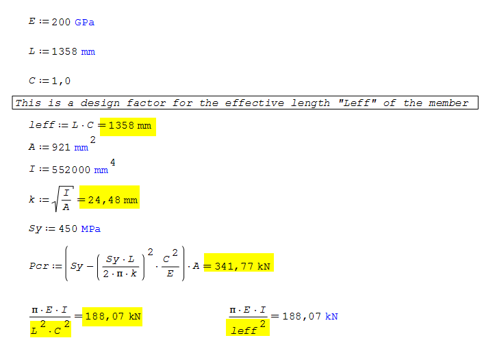

I'm not sure if I get what you want, here is an updated file... other than displaying the results, I'v modified the main equation since you had L^(2*(C^2)) instead of (L^2)*(C^2)
Chord Buckling - Load Case 1_A.sm (9.21 KiB) downloaded 1354 time(s).

Davide - thank you once again - for not only looking at this but also proving an updated file.
All the results you have highlighted match those in my spreadsheet which is terrific and what I wanted.
I understand the correction you have made to my equation - I just have to try and figure out why I couldn’t get the results to display if the other equations were OK.
I will put your file somewhere “safe” as it will be a terrific asset for me, and have another tinker with my file.

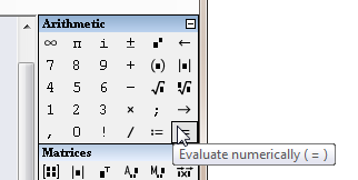

Currently I can't test it on linux so I'm not sure what is the issue. In theory if you are running the same Smath Studio version there shouldn't be problems...
maybe a keyboard layout difference? In this case you can try to click on the "evaluate numerically" toolbox button to try to dispaly the inline result.
