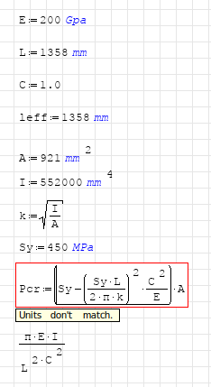

I have tried to reproduce the sheet with a different steel member but perhaps not surprisingly come up against a few problems. A second screenshot and the file is also attached.
I would like to understand:-
1. how he managed to convert the variables A and I from mm^2 to m^2 & m^4.
2. Why my units don't match.
EDIT - I have applied mpa unit to the Sy value - with no effect

2. Units don't match because there are two different errors.
In the first screenshot there is a typo in the definition of E: the unit is written as Gpa (lowercase p) but it should be GPa (uppercase P).
In the 2nd screenshot there is also no unit assigned to Sy.

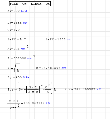

Well I have made some progress. After correcting the E units and entering the units for Sy I was able to get a result for the equation at the bottom of the sheet below "Pcr".
From that I presume that Variables E, I,L, and C are correctly entered. The units now also seem to match on the "Pcr" equation.
Nevertheless I still cannot produce a result for that equation or for "k" and "leff" (which is L multiplied by C (design factor))
I also tried the example on page 7 of the SMath primer and got a result for that.
I am wondering if I have an incorrect settings (seems unlikely)or the problem is related to the fact that I am on a linux machine with SMath installed via the "wine" windows installer.

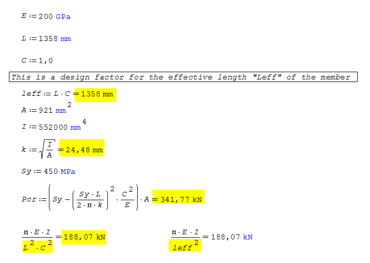

WroteI'm not sure if I get what you want, here is an updated file... other than displaying the results, I'v modified the main equation since you had L^(2*(C^2)) instead of (L^2)*(C^2)
Davide - thank you once again - for not only looking at this but also proving an updated file.
All the results you have highlighted match those in my spreadsheet which is terrific and what I wanted.
I understand the correction you have made to my equation - I just have to try and figure out why I couldn’t get the results to display if the other equations were OK.
I will put your file somewhere “safe” as it will be a terrific asset for me, and have another tinker with my file.

Davide - I have finally been able to display the desired results on my PC, however not quite the way I would have expected based on your file. By way of explanation:-
I decided to upload my file to "SMath Studio in the Cloud" and was able to set the units and produce the results using the menu item for units and the = sign. From this I concluded my sheet contained no obvious errors.
So I then went back to my PC based file but was still unable to display a result for leff, k or Pcr using the same method. By chance or intuition I decided to type leff= to the right of the equation and this displayed the result? Using this method I was able to produce the results for k and Pcr.
I have attached my updated file and a screenshot of the cloud file.
I am happy to follow this procedure on my PC even though it seems unusual. I still suspect it may have something to do with the fact that I am using the application via the Wine windows installer on a Linux machine.

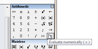

maybe a keyboard layout difference? In this case you can try to click on the "evaluate numerically" toolbox button to try to dispaly the inline result.
WroteCurrently I can't test it on linux so I'm not sure what is the issue. In theory if you are running the same Smath Studio version there shouldn't be problems...

maybe a keyboard layout difference? In this case you can try to click on the "evaluate numerically" toolbox button to try to display the inline result.
I tried your suggestion "evaluate numerically" from the toolbar but it didn't work. I think my installed version was not quite fully compatible with my operating system - image attached.

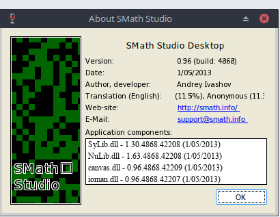

I didn’t attach the version details in my reply to Davide Carpi - oops - Monday
I didn’t read overlords suggestion properly - apparently I can install Mono on my Linux machine - I will have a look into that next week.
WroteI have just realised two things:-
Image of the original installation version details attached. It looks like a very old version - not quite sure how I managed that.
Regarding Mono I have isntalled Mono Runtime with the MX package manager so there shouldn't be any problems with that once I figure out how to use it.
As things stand I have SMath Solver installed and it seems to be working well so I will leave things as they are for the time being.
Thank you both for your help.
WroteIt is indeed a very old version of SMath.
Try this latest version.

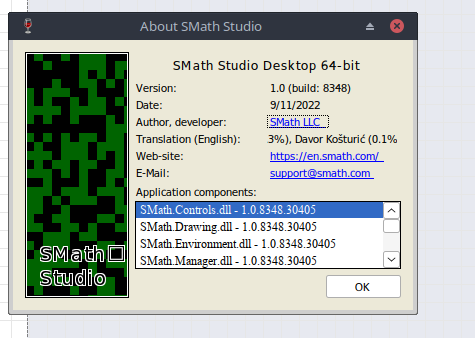

Is this different from what I already have installed? - see details attached
Latest stable release is 1.0.8348 and it is released in 2022.
A lot of changes and corrections are applied in these 9 years.
If you can, always use at least latest stable release.
Nightly builds are also usually rock solid.
WroteVersion you had installed was released at 2013.
