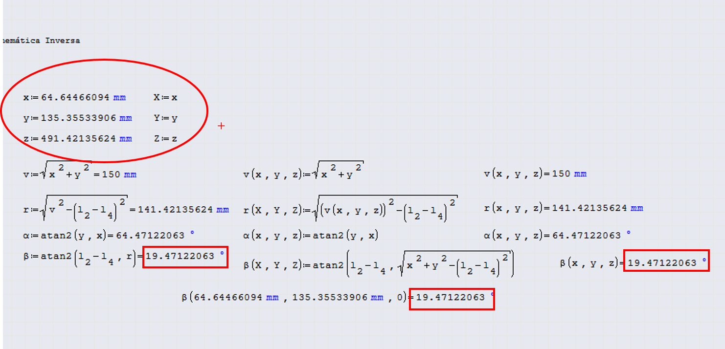

Hi, I am having some issues Here,
As my english is very bad, I prefer to show you the picture about my problem
If I make step by step caculations, the answer is correct (Which is 19.47°). When I try to make them using user functions, the answer is wrong even if I am using the same values for parameters.

This is a bug.
The problem is triggered by your naming. You use x, y throughout your functions. It seems that actual parameters names interference with dummy parameters names. Here it's evident: arguments-bug.sm (2.61 KiB) downloaded 1362 time(s).
To workaround, please change names of parameters in your functions, namely in atan2. E.g., you may make it atan2(yy;xx):= ....
Created SS-2327.

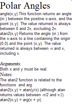

"Universal Implementation" of atan2 is as adopted since the very first day of FORTRAN,
respected in Mathcad 8/11 but not in your Smath version.

#13 Posted: 4/23/2016 8:51:10 AM
Your version of Mathcad uses non-standard definition, but that doesn't make it standard.
Ask Uni about his Mathcad version more recent than mine [8/11]
'tan' is Y/X we know that since ages. But polar angle is this way,
Both in Smath 5436 [correct] and Mathcad 8/11 also correct.
And the two are correct by the books.
A bug is a bug, end of it.
