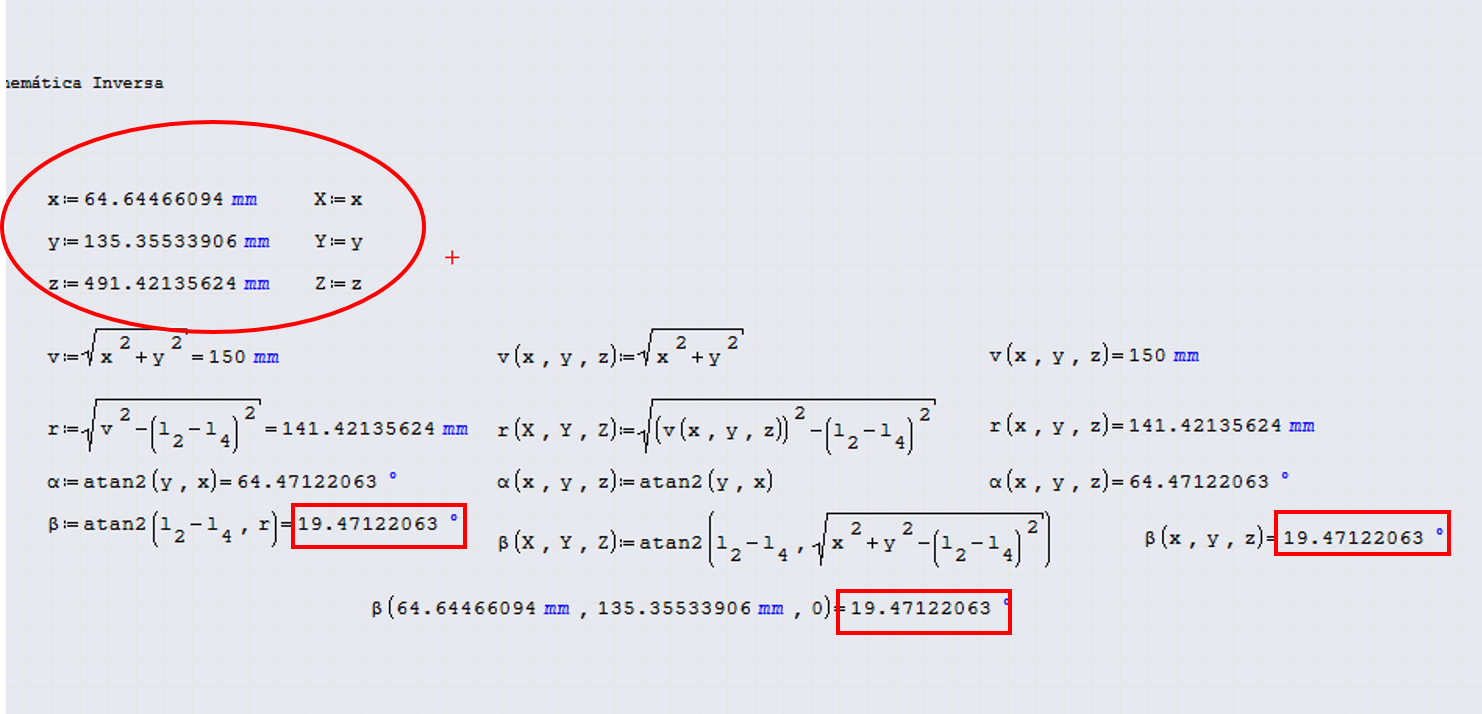

Hi, I am having some issues Here,
As my english is very bad, I prefer to show you the picture about my problem
If I make step by step caculations, the answer is correct (Which is 19.47°). When I try to make them using user functions, the answer is wrong even if I am using the same values for parameters.
#2 Опубликовано: 22.04.2016 02:50:11
Mike Kaganski
Mike Kaganski
This is a bug.
The problem is triggered by your naming. You use x, y throughout your functions. It seems that actual parameters names interference with dummy parameters names. Here it's evident: arguments-bug.sm (2,61 КиБ) скачан 1362 раз(а).
To workaround, please change names of parameters in your functions, namely in atan2. E.g., you may make it atan2(yy;xx):= ....
Created SS-2327.
С уважением, Михаил Каганский

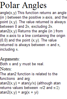

#11 Опубликовано: 23.04.2016 07:35:15
By definition, atan2(y,x)≡arg(x i*y)
Please notice that atan2 has y and x in "reversed" order.
What is "UNIVERSAL IMPLEMENTATION" of atan2? Link please.
Answer: WRONG, bug in your Smath version.
"Universal Implementation" of atan2 is as adopted since the very first day of FORTRAN,
respected in Mathcad 8/11 but not in your Smath version.
#12 Опубликовано: 23.04.2016 07:46:22
Mike Kaganski
Mike Kaganski
Oh really?
Let's ask IBM, the Fortran inventor:
http://www.ibm.com/support/knowledgecenter/SSGH4D_14.1.0/com.ibm.xlf141.aix.doc/language_ref/atan2.html?lang=en
Your version of Mathcad uses non-standard definition, but that doesn't make it standard.
#13 Опубликовано: 23.04.2016 08:51:10
Ask Uni about his Mathcad version more recent than mine [8/11]
'tan' is Y/X we know that since ages. But polar angle is this way,
Both in Smath 5436 [correct] and Mathcad 8/11 also correct.
And the two are correct by the books.
A bug is a bug, end of it.
