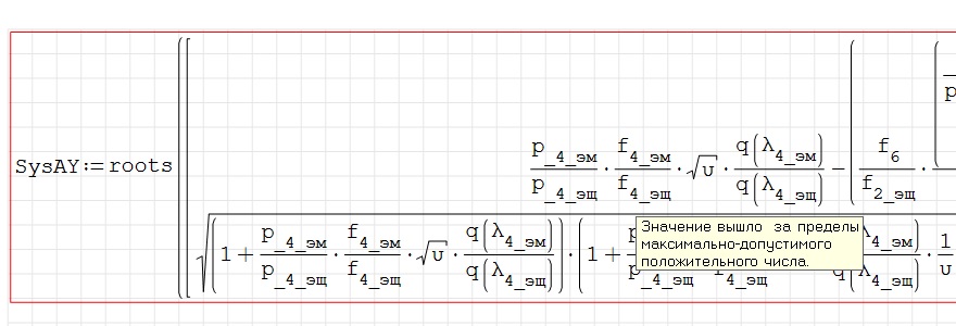

Who has faced such a problem, how can it be solved?
Project from below
Poverochnyjj raschjot ehzhektora.sm (84.1 KiB) downloaded 1157 time(s).
#2 Posted: 2/12/2020 12:07:47 PM
"result above max ..." has no pertinent meaning in your project.
If you attempt "roots" on the numerator only ... "Units don't match"
No need to go further ... zap the units in the project.

I made a mistake, there should be a solve function, in this place the same error
#4 Posted: 2/12/2020 2:57:49 PM

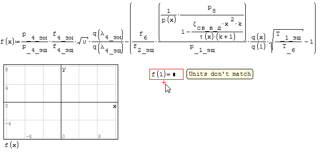

Same answer: Units don't match.
How can you solve what you can't plot or evaluate ?

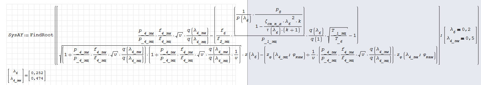

You can use the function FindRoot() from the Nonlinear Solvers plugin. The function automatically assigns the solution to the variables.
Единицы измерения здесь не при чем.
2020-02-13 11_38_00-SMath Studio 0.99.7251 - [Poverochnyjj%20raschjot%20ehzhektora.sm_].png

#10 Posted: 2/14/2020 10:56:17 PM
Common from ill posed construction.
Consider yellow up until you can plot that system(x,y):= ....
from there it should be solvable.

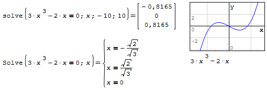

Go on dreaming. If you are in non-linear systems and you can't find a symbolic solution (Maxima's Solve() got stuck when I tried) then you need numerical procedures for solution. These always need an initial guess (Newton-Raphson) or a search region (bisection). The various procedures just differ in how efficient or how robust they are. Some of them may have quite impressive radii of convergence for particular systems but none has infinite radius for all systems.
Furthermore, there remains the problem of uniqueness of a solution. The only solvers in SMath capable of providing multiple solutions are the
  • solve() finds all solutions of a single equation within a given range
  • Solve() from the Maxima plugin, which finds symbolic solutions.
Blatt21.sm (5.23 KiB) downloaded 1169 time(s).

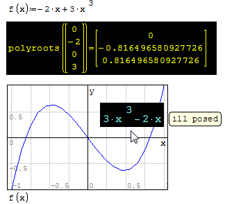

#13 Posted: 2/15/2020 5:54:43 PM
Always avoid ill posed polynomials.
