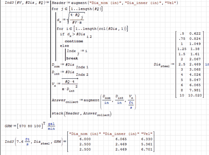

I need the information for 1 pipe diameter smaller ... sigh, I hate programming
PipeVel.sm (10.74 KiB) downloaded 1167 time(s).

Here is a solution
PipeVel_CBG.sm (8.94 KiB) downloaded 1245 time(s).

Muchas gracias Carlos. Lo que no podia ver es la indice else --> index.j:1 Handaba pensando en algo similar para retener el numro viejo, pero nada se me vino a la mente.

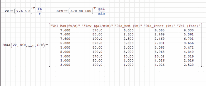

Ruben: A slightly more complicated algorithm, which supports several speeds and several flows.
PipeVel_CBG_R1.sm (14.85 KiB) downloaded 1266 time(s).

I'm looking at sizing pipe at low flow, then calculate velocity, fixed pipe dia, at a higher flow. With your original code, I set this up in two steps to look at VFD driven system.
