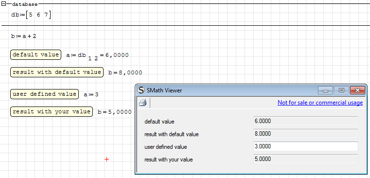

I use Smath Viewer - *.exe
How to make it possible to enter data in a field that receives the calculated data,
Explanation in the picture
#2 Posted: 10/29/2017 1:17:16 PM
Hello Kriss,
you can't as well as you can't enter data in results in the worksheet (or in result's cells in excel, f.e.); what are you trying to do exactly?

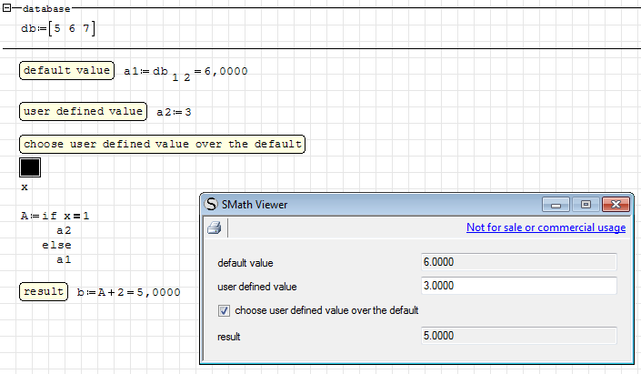

I understand the point, as for now the only way is to change the logic of your script (f.e. creating a tab with database-driven inputs, another with user-driven inputs) or to use controls (checkbox, combobox...) to drive the behavior

#5 Posted: 10/30/2017 12:01:50 PM
Thank you, Davide Carpi!
Yes, I also thought about this solution.
If there are no other suggestions, I will use your proposed solution.
