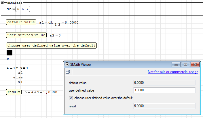

For example,
the data retrieved from the database or a calculation
and the User can change this value or accept the given value.
(In other words - the default value)
as a variable a, as shown in the picture above, because we initially set the value that the user can change it

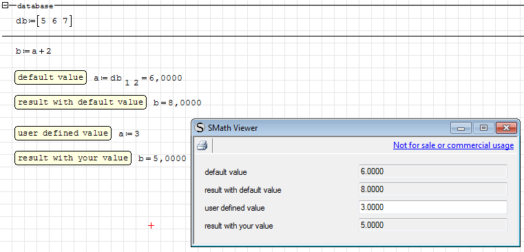

#4 Опубликовано: 29.10.2017 15:04:46
I understand the point, as for now the only way is to change the logic of your script (f.e. creating a tab with database-driven inputs, another with user-driven inputs) or to use controls (checkbox, combobox...) to drive the behavior

#5 Опубликовано: 30.10.2017 12:01:50
Krid
Krid
0 сообщений из 16 понравились пользователям.
Thank you, Davide Carpi!
Yes, I also thought about this solution.
If there are no other suggestions, I will use your proposed solution.
