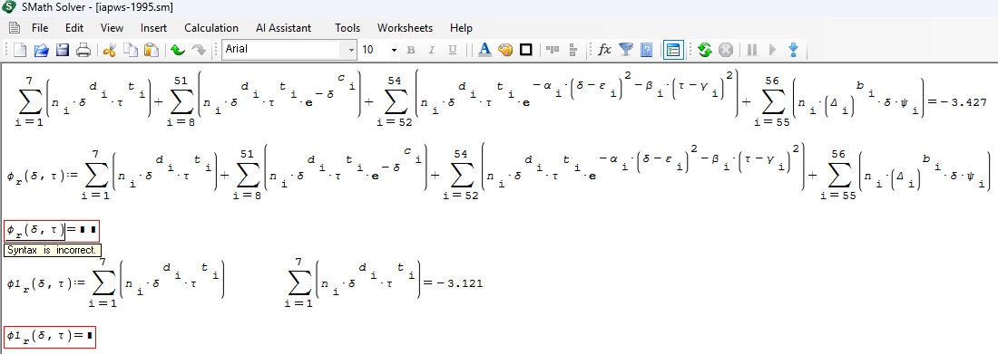

#1 Posted: 5/22/2026 4:47:56 PM
Valery Ochkov
Valery Ochkov
67 likes in 713 posts.
See the end of the sheet.
iapws-1995.sm (220.46 KiB) downloaded 502 time(s).
Edited 5/22/2026 5:26:14 PM

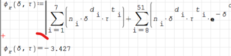

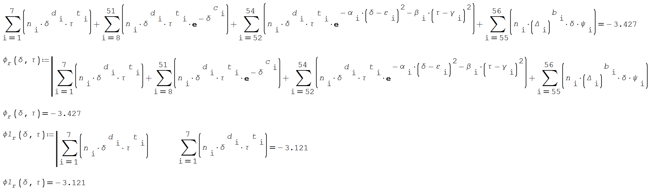

#2 Posted: 5/23/2026 5:08:54 AM
1,139 likes in 1,805 posts.
Hi. Use line(#) for prevent the evaluation.
iapws-1995.sm (220.77 KiB) downloaded 508 time(s).
Valery Ochkov 5/23/2026 8:36:01 AM, Andrey Ivashov 5/23/2026 5:12:56 PM
#3 Posted: 5/23/2026 8:36:34 AM
Valery Ochkov
Valery Ochkov
Thanks and why?

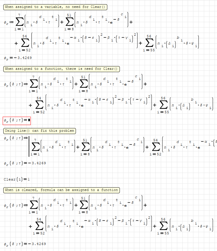

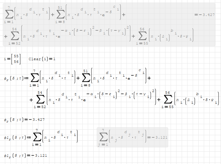

#4 Posted: 5/23/2026 11:03:47 AM
600 likes in 1,381 posts.
This happens because your i is not empty.
Try to clear it or use something different for sum iteration.
j would be appropriate.
Andrey Ivashov 5/23/2026 11:18:20 AM, sergio 5/23/2026 5:20:38 PM
#5 Posted: 5/23/2026 11:19:15 AM
2,343 likes in 4,056 posts.
Thank you overlord!
Another way is to use line() at the rhs:
#6 Posted: 5/23/2026 4:18:22 PM
Don't know if this is a bug or limitation.
But when formula assigned to variable or used directly, it can be calculated.
When assigned to a function, it can't be parsed.
